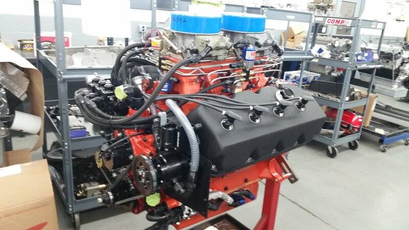

This is new tunnel ram combo I just finished up. It’s a 605ci 11.5:1 pump gas hemi with 500 shot.
The BG carbs are just for show. These are 3 circuit carbs that will not do in street conditions as they are.
I will be ordering a pair of 2 circuit dominators for this early next year. This is going into 67 Coronet so I’m not putting much info on it here. This should be fun ;-)

Coronet with that 605 ran 8.00 1/4 with full interior. Now plan is to make it more of a street strip situation without loosing the balls on it. I am tempted to do some more work on that intake, but first need to get the carbs and see where I am.

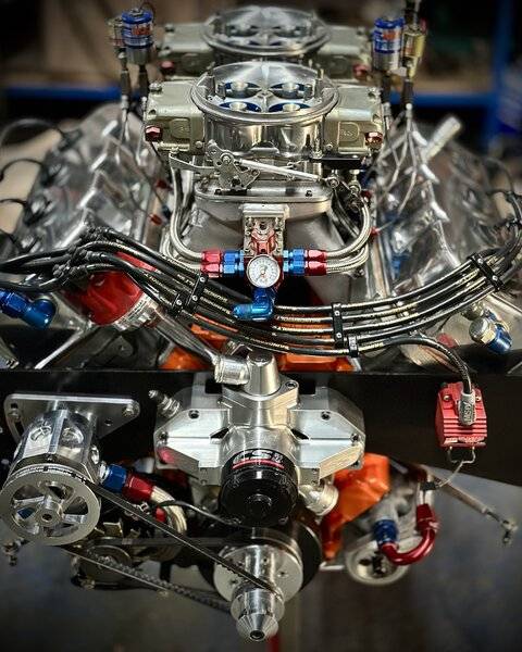

470” low deck
6.700 chevy rods
Molnar 3.91” stroke crank
10.6:1 -12cc step dish piston
Solid roller 254 @ .050
Trick flow 240 heads
Twin 750’s built by bigs
Runs 9.80’s on pump gas driving to the track.
what gearing in the rear end ??

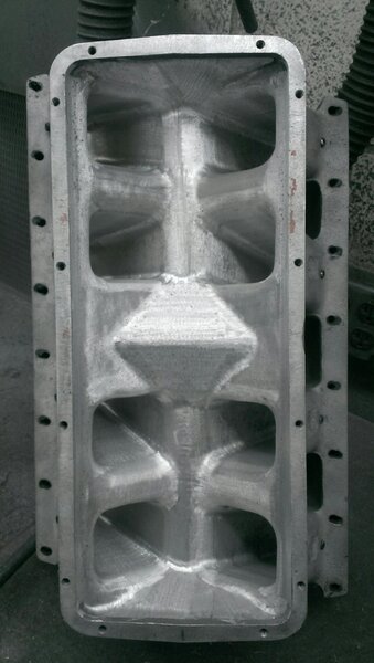

This was a lot of work, but the work paid off as this standard port tunnel ram only fell off from peak 5800 to 6800, 60 HP.
Prh told me he tested this same manifold untouched and it was over 120 HP.
It's ugly on the outside but inside it's beautiful.
I love burr finish, my 1st burr finish too.
Send it over, I will make it look nice on the outside if you want ;-)
