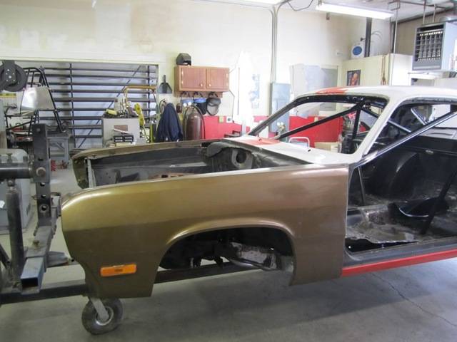

Leal car on the rotisserie this week for the core support, front inner fenders, firewall, front half of floor and the spare tire well. After a few more days of welding and grinding it goes straight to our body and paint guy.
Even though this car was all white when new, it will follow Chrysler's build dictate where by the entire shell gets painted black and then the exterior of the body only (not the engine compartment, door jambs, trunk, wheel wells etc.) will receive the final finish.
Have not even broke the news to John (OMM) yet......but according to my recently acquired 8" x 8" glossy photos / proofs from the April 1975 Car Craft photo shoot....the front attaching points for the ladder bars will be removed and returned to original. I have a excellent photo showing a much more simple non-adjustable (up / down) mount (perhaps front to rear adjustable) that utilizes a quick release pin. No additional side to side round tube bar or the round tube re-enforcing lateral supports.
Due to the look of the age of the front ladder bar mounts, I would have guessed them possibly original....but when I scrutinized the welds, I became suspicious. Then I started looking at action photos of the Flash racing in '75 and '76......and came to the conclusion.....it was raced by Butch as pictured in the Car Craft photos. I'm guessing the mounts were modified / changed when the leaf springs were removed and the rear coil overs added. From every picture I have seen (wheels up) the leaf spring / ladder bars worked great.

but, that is why I went back and looked closely at the Flash being raced in '75 and '76....you can see the bars configured as they are in the CC photos
when I examined the welds with the Flash on the rotisserie Friday afternoon is when I became suspect....but then when I arrived home, the pictures were on my doorstep.....and told the tale.
Checked with Gary and confirmed the simple front ladder bar mount was never altered by him, especially to what is attached now.....the best part is, upon closer inspection, ALL of the original mounts are still there, simply added over them.

No. Found some new info about different original ladder bar mounts hidden by the current ones that evidently were added later when the coil over shocks were installed. Further investigation and some previously unpublished original B+W photos from Peterson archives of the Car Craft magazine shoot confirmed this. The original simple front ladder bar mounts have been unearthed. The car is still on the rotisserie while more repair welding and grinding is being performed before the trip to the body shop.

just a tid-bit....when Mark closed the holes for the charging ports and the battery cut-off switch on the rear tail panel....the heat caused the surrounding paint to bubble. The Flash's exterior must have been painted 4 or 5, even 6 times....always over the top of the previous paint job. The bottom...only black / once
our plan is to go down to the factory white....and go from there. More than likely we will to see exactly where the original red / white / blue striping was located....it is under the layers......somewhere.
The California Flash is just about ready to come off of the rotisserie.
The prototypes of the elephant ears have been created in steel and will
be replicated in aluminum with the original patterns. The prototype headers have been fitted and only have the special replica collector ends to be installed. Right now the mid-plate / bell housing area is being finished.
