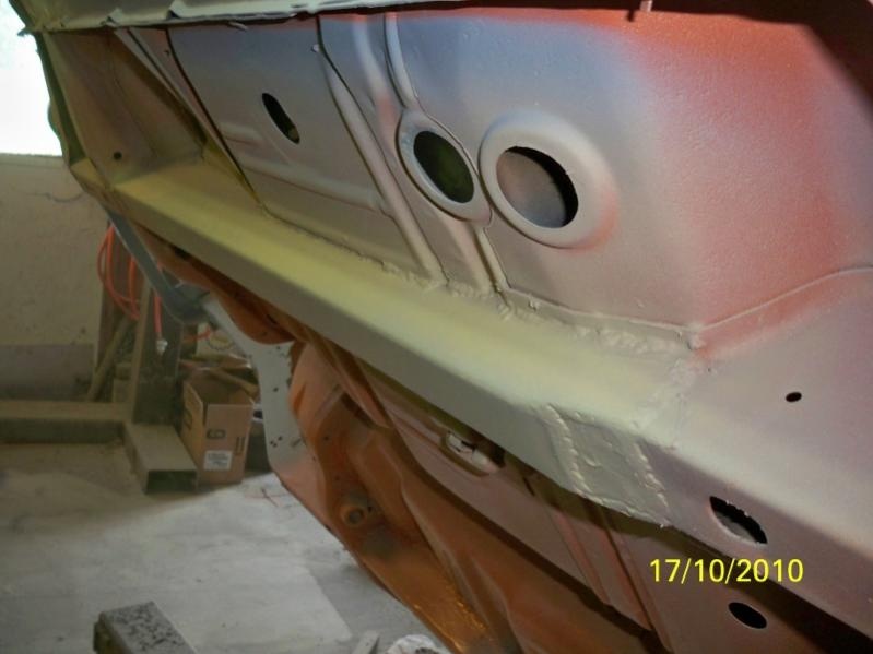

I did this myself with 12 guage, it took some time cutting but it came out well.
attachment.php
