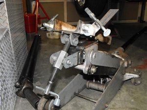

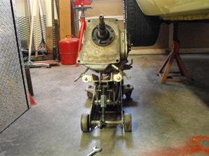

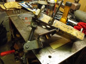

I`ve just buttoned up my clutch replacement. Like most guys, I just have 4 jack stands and a 3 ton floor jack. I pull my trans by myself and have lost it or have it slip and hang the clutch, a big no`no. Ive finally modifyed my trans rig where it works perfect. Just thought I`d pass it on. built it with materials that I scavenged or salvaged.
