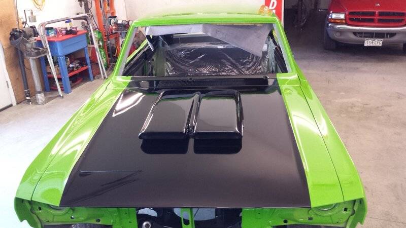

I posted the system I made on this forum. Maybe it would work for you. You may find it by searching for
‘Functional twin hood scoops’. If not, post again and I will look for it if you are interested.
In case someone wants to refer to it.

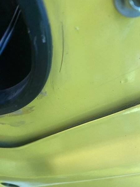

The groove in my ‘donut’ measures 3.935” or about .2” (3/16”) smaller than the recommended 4.125”. Even a 4” hole would be slightly large. Will post a couple pictures as soon as I can get them to download from my phone. As said before, DO NOT make your hole before checking.

My hood with ‘donut’ pushed to the right, the second to the left. Reference to my above post with hole measurements. Note the pencil mark.

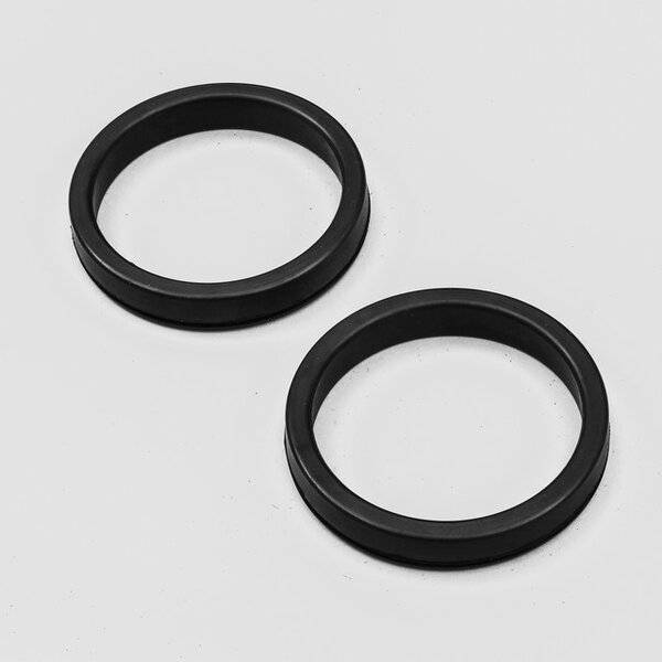

So I got my 4-1/8" Lennox hole saw and the rubber rings from DMT and if you look at the groove in the picture below, it is pretty much a perfect match for a 4-1/8" hole. Now you could say on the right side the grove is not lined up with the saw but hey, its freaking rubber so if I rotated it I could have got a perfectly lined up shot. It's impossible to measure the grove dimension with a dial caliper unless you have a caliper with a very deep throat to get to the max diameter and even then, the groove is so thin the caliper blade would start distorting the round shape...
Like @Yote suggested, replace the bit with a round rod once the pilot is drilled to keep it from wandering as hole saws tend to do. Who knows, maybe DMT is using a different vendor? All I know is it looks perfect to me.
