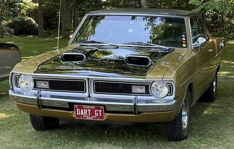

I used 2012 Jeep Wrangler headlamps (halogen bulbs) in the Jaundiced GT. They're a bolt in, but the vehicle wiring will need to be modified to accept the Jeep Wrangler headlamps. I also installed relays at the same time.
