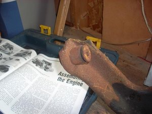

Old Control Arm

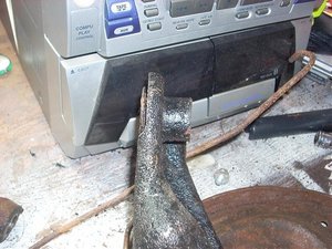

New Control arm (see the "top hat") does this come out?

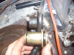

New Bushing...also with top hat

The collar and face don't look like they come out, but I can't see the new bushing going in any other way...unless it is a very very tight interference fit.
Thank you very much, my top hat has got to go. That should make things much easier.
Thanks again Cudaman!
