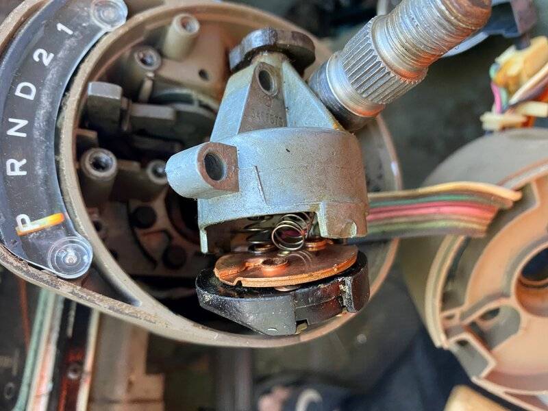

Hello. I recently picked up a '74 Dart. Tracked down an electrical problem (Someone re-routed the hot wire to the column because it looks like it shorted with no fuse and melted the connector in half, etc.) The source of the problem was the ignition switch, the crimping on the plastic cap failed and the 3 springs inside looked like they'd been in a blender. Took it apart got a couple springs from the hardware store, put it all back together. Lasted a handful of drives, came apart again. Picked up a Standard Ignition PN: US88. It fits poorly, the arm is a bit longer than the original so it wont seat all the way into the key mechanism, however it works. The RED wire isn't pictured but it's connected to the battery.
The problem is, the key ON position runs the starter non stop and the START position shuts it off. The car starts and runs. If I swap the BLACK (ON/ACC) and YELLOW (START) wires at the connector it should fix it?
Any insight is greatly appreciated.
I read through a few threads and didn't see my exact issue, apologies if it's there and I missed it.
Thanks!

Thanks for the info. I'm pretty familiar with the wiring now and troubleshooting it. Had to hotwire the car to see if it even ran. Seems the seatbelt interlock has already been bypassed (Thanks for noting what that box with the button is).
The car operated correctly before the ignition switch came apart, again.
The wiring colors are matched to the factory wiring.
Just realized I can cycle the switch outside the column to prove/disprove that fit is the issue.

The contact plate in the switch was floating around when I originally opened up the column.
I use a fluke multimeter in 12VDC mode, or a 12V mac tools automotive test light when looking for power. If it's continuity I use whatever the "beep" mode is on the multimeter.
The issue is related to the -new- switch itself. It's the part number listed for my car but there is a note in the box explaining how to wire it for different year vehicles. It seems that none of the notes that came in the box require alternate wiring of the main wires. The switch is sending constant and momentary power to the wrong places. I'll map out the function of each wire with the test light and see what I get.
It’s not the fit. Cycled the switch outside the column. Same results. Constant power to the yellow wire. Compared the new and old switch, totally different wire locations on the back. Went to Napa. The switch they have also doesn’t match the factory switch. Any idea where to look for a switch? Nothing I’ve found online matches.

NAPA showed they had the correct switch. Went there and matched up the OEM switch, all the wires were in different locations on the switch body just like the replacement I already have installed. Rather than going through the $$ and wasted time again, I drilled a hole next to the cigarette lighter and installed a push button for the starter. Works great. Also, the wires at the switch body had some terminated with a swage and solder and some just swaged so I soldered the rest.

Yes, and it all makes sense. If I put direct power to the wires that require it, everything works as it should, the car starts and runs.
The wiring on the back of the replacement switch doesn't match the original.
The replacement switch doesn't interface smoothly with the key cylinder.

It's not going to either. THe internals of the switches are different from the OEM switches. I recently went thru this myself.
You'll have to map out the circuit and pin it out so that it lines up with the dash side of the harness.
It took me a few days of internet reading and reading thru the FSM i have to wrap my head around it too.

I would map things out before you install it. Here is the basics, you can make a "truth table"
POWER IN. This was originally a large gauge wire, varied in color.
ACC out. This connects to POWER in both ACC and "RUN"
IGN1 "run"..This connects to POWER in "RUN" I would guess also shows continuity to ACC in "RUN" IGN1 is hot ONLY in run, and goes dead in START
IGN2 and START. These are separate contacts and should not show continuity to each other in "OFF" or "RUN" or "ACC" Both these should connect to POWER when twisted to "START" IGN2 feeds power to ignition system in "START" and it's purpose was to provide "full battery" power to ignition and to bypass the ballast resistor in START
START was yellow for most years, IGN2 was brown.
EDIT....The IGN2 goes one place...out through bulkhead to coil+ side of ballast
The START wire only went one place as well--out through the bulkhead, to the starter relay
Since you have a 74, make sure the yellow wires at the seat belt relay interlock/ reset--out on the fender apron under the hood--make sure that you splice the two yellows permanently together to disable that interlock. Also don't forget that start relay will not engage without a ground at the second terminal of the relay coil.......the transmission neutral switch with auto, or the clutch switch with a stick
