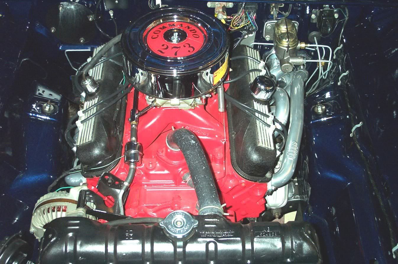

Engine bay- tried to make it look like a 273, some giveaways are Dougs headers, air gap manifold, Holley. Also hid small batttery in spare tire well, heater delete, dual master, MSD distributor w/ black cap. It's a 340, 4.08 bore x 3.79" stroke (396 CI), hydraulic roller, very light rotating assy (it's a revver).
Nice job man. I've never been a big valiant guy but yours changed my opinion. I bet that motor is starving for more air out of that cleaner. My car came with the hipo 273 and after I changed the stock air cleaner it could take in some gulps and woke up. I wanted to take a stock air cleaner and do a dual snorkel with ram air tubes to trick it out a bit. Nice car man
Looks great under that hood! I agree with gtmopar though, they make a drop in K&N element for the commando air cleaners like that. Im sure that in the least will make a difference.

Has both a K&N element plus no choke housing (machined off a vacuum secondary 750cfm Holley 4160). Flow is good!
