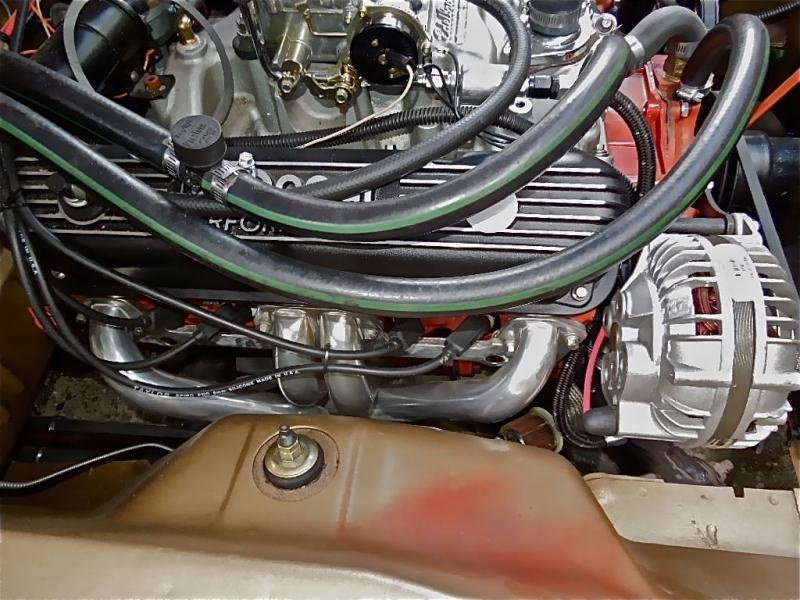

Also I found the pic that another member has of the setup, this is what i'm looking to achieve:
http://www.forabodiesonly.com/mopar/attachment.php?attachmentid=1714537036&stc=1&d=1346198846
One of the Mopar gromments worked on the PVC, but was too small on the breather, I recently ran into this issue and ended up slicing and dicing a gromment on the breather and still couldn't get it to work, thats when I decided to put in a PVC valve without the guts, making it open all the time, worked fine. I hope your covers dont leak, Im having issues on the back of each head leaking.
I was lucky I got grommets with my valve breather kit.I had to drill out(as cast Mopar valve covers)the holes and modify(trim) the grommets to work.
