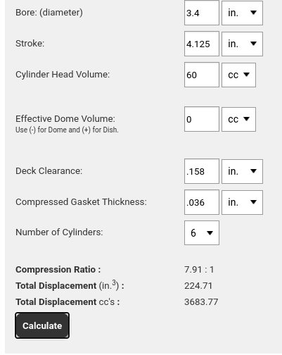

Ok thanks all for the good info i have a better idea of what i need to do now. I have another question about how much to shave off the head. I am keeping the stock bottom end and using a .040 felpro and want to have a target compresion of 8.5:1 but dont know how much to take off. I know there are calculators but shaving the head will affect teh cc and i dont know how to calculate the new cc.
0.060 off the block and 0.020 off the head gave me around 8.6-8.7 with a OEM steel head gasket.
are you sure you can get there with just cc volume? I have not studied your calculations here in depth but I recalled it would take a ton of shaving to get the cc’s to mid 8 CR when I was doing mine.
Well using all my dimensions except the head cc and to get to 8.5:1 i would need to mill 46 thousands which does not seam excessive.
I got to over 10:1 with milling the head on my current engine.....although it was not on purpose. LOL
well i am unsure of what my current cc is because im getting larger valves installed then i will cc my head and then cc the head after but i doubt it will be larger then 60
I had oversized valves installed too and it did not make much difference.
