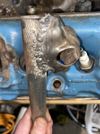

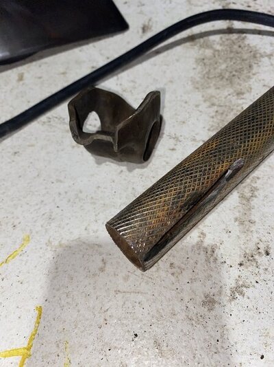

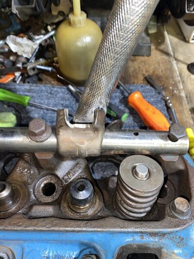

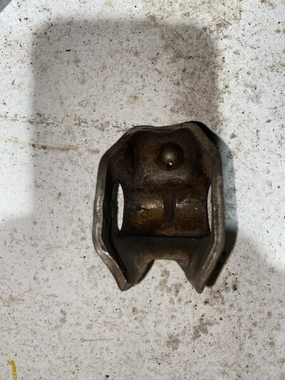

Line up a rocker where you want it to be welded and mark. I used a paint marker. Angle grind a slot for the rocker arm to sit in off to the right or left if preferred.
Grind a v notch outta the end of the arm after a mock up on the head with a valve in for alignment ish.DC265EAC-6C0B-4236-99BB-F603FF730408.jpeg
Weld the piss out of them but do a better job than me with flux core, renamed “splattercore” when I weld.
Whats the old joke? “I’m a welder from way back…when I weld you gotta stand way back”.
Nasty

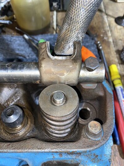

Slide it on a rocker shaft and install the shaft with two factory bolts minus one “washer” for clearance on the end/right. I put a rag in the combustion chamber to keep the valve in its place.
Do your thing.
Slide it over and on to the next spring.

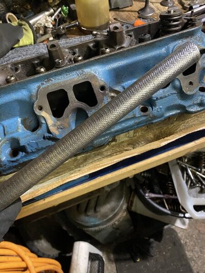

The only problem I ran into (other than the shooty fluxcore, the other F word) was that I did’nt make this when I was a teenager.

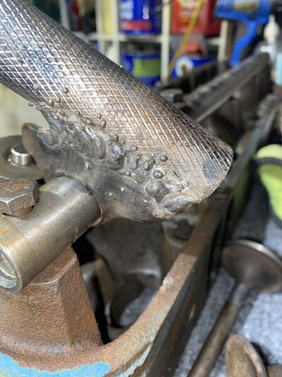

Cant believe how well it works and how easy it was to make in about an hour all in.
Just have to be careful because of the leverage not to bind the spring. So strong.

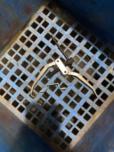

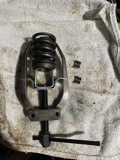

I used this one a few times. One thing nice is you adjust it once and then flip the lever.
Time to make a better one...even with nut welded on theres still a fair amount of wrestling lol.
What size C clamp did you use?
OUCH! It's almost like they want you to hurt yourself using it. These knobs don't feel good in your hand, that's for sure. Mine is at the shop, but if I had to guess I'd say it's a 10" (25cm) clamp. The main drawback IMO is that you can't use it with the heads installed like the ones toolmanmike and others have posted.
I used this one a fe times. One thing nice is you adjust it once and then flip the lever.
Thanks, the one I have now is easier with socket welded on but it is still a pain. I'll make a new one as well for "heads installed" scenario.
