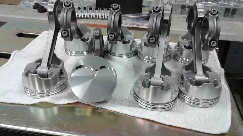

Got my pistons and rods NASA clean for install tomorrow. I've always used the same sort of "recipe" since I was a kid. Far as I know I've always had a good ring seal.

BTW, I'm liking your rods a bit too much. Pretty nice stuff.
I was going to go H beam, but would have needed a couple slugs of Mallory. Scat calls these their Pro Series. Fairly light. I have them in my current motor. Have held up extremely well over the years. I did upgrade to the ARP 2000 bolts this time, so in my mind, I'm solid.
Pretty decent Bob weight, too. 1733. Nice split too at 886/847.
