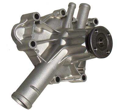

I'm going to run this one from Milodon. It's high volume and has an anti-cavitation plate on the back of the impellers.
I'm also running a three core Champion radiator with dual electric fans and Evans waterless coolant. I'm not taking any chances. Nothing worse than a slow crawl at a cruise night and watching your temperature guage creep up. Never again.
Not sure how it compares to an Edelbrock pump. I have one and took it off. Water had to much velocity. I only ran it for a couple of days. Went back to the eight vane a/c pump. Pump for sale $25 plus ship
