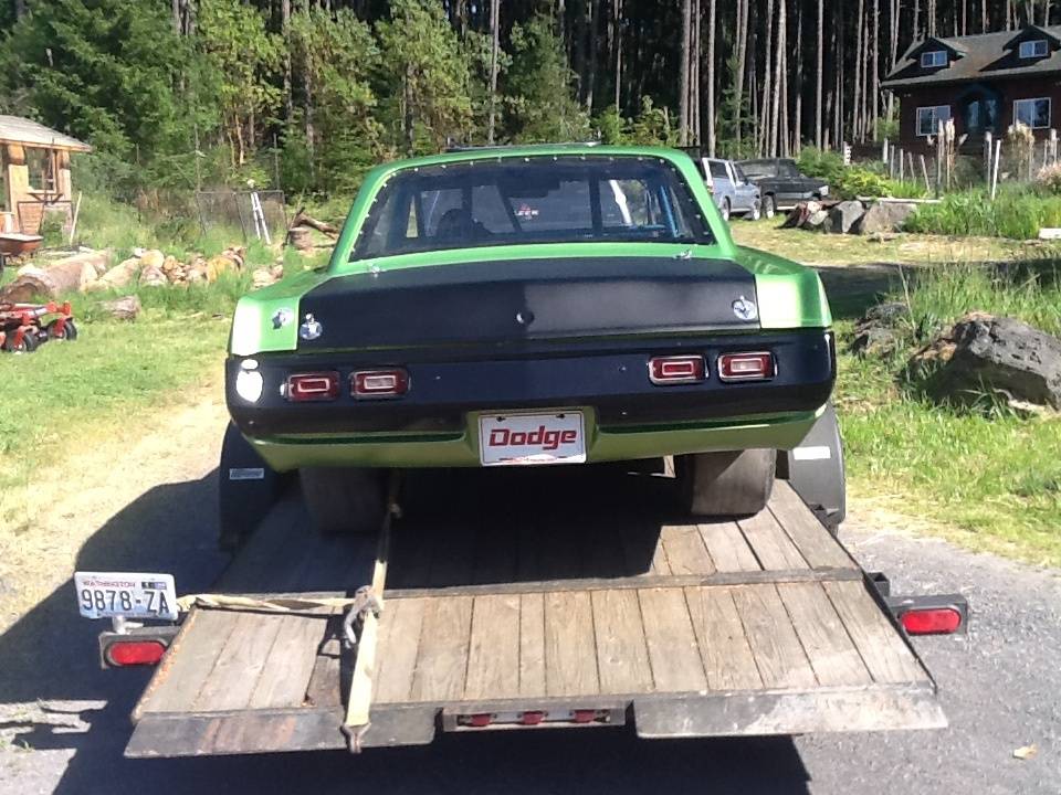

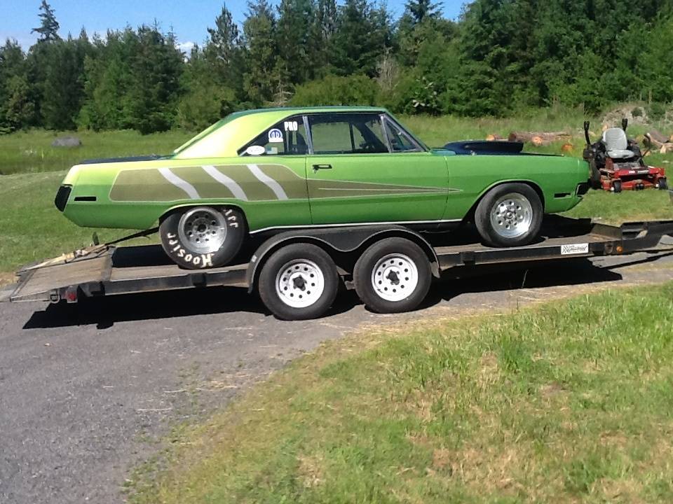

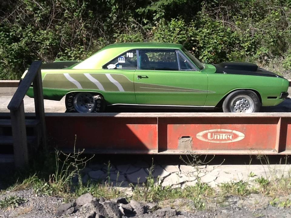

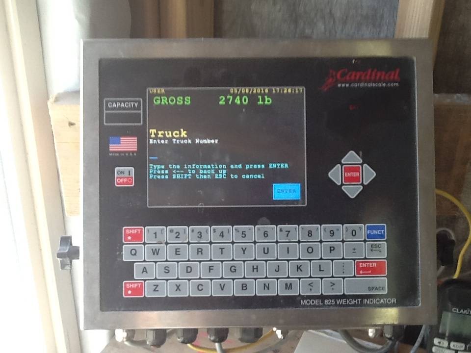

was pleasantly surprised! 2740 lbs with 4 gallons of fuel. Rms manual rack,art Morrison ladder bar car. Polycarbonate windshield and rear window. Currently magnum crate 360 727 gear vender set up I put in out of my other dart after I blew up the 340 at woodburn end of last summer. 340 is being built now into a 430 stroker with closed chamber eddy heads and my 904 that has a 8 inch converter and a 5000 stall. The 360 is iron headed now, should lose another 120 or so pounds with the new combo. Should be able to go racing second or third weekend in June. Also have fiberglass bumpers and brackets,glass hood and decklid. Will be removing all glass and regulators except drivers door window as I have time. Now dart

you'll definitely lose weight dumping the 727/gear vendor for the 904. Not bad for that era of Dart.

I still have 2 batteries in the trunk, going to put a small alternator on the 340 and get rid of 1 battery. Will be pretty cool to get to 2550ish

Hi Jason, I will be there. This was the blue dart that I painted this winter. Exited as as all get out to run the new combo. Rich
It really does look badass in the green. I did start a thread on events about the Mopar Nationals in Oregon. What class are you going to race in?

I don't think you'll have any trouble with low tens that's a really sweet build! I'm pretty sure my son will be racing in the Pro class with my car like last year, but I'm thinking about racing the stick shift class this year instead of having him race both.
