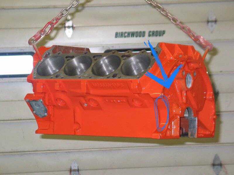

I’ve had this problem with a 400 block. I had to grind the area circled in blue.
