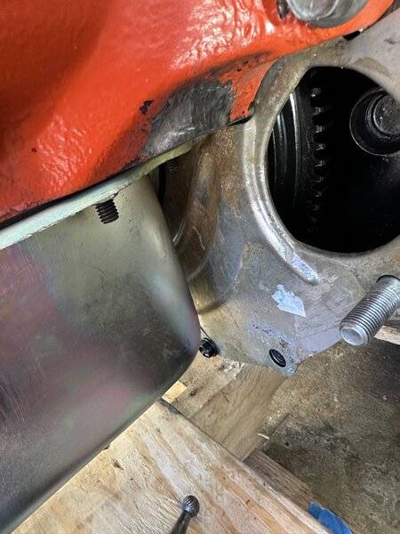

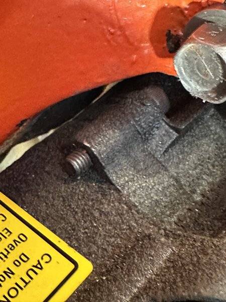

I thought I would give an update on my magnum 408 to 904 starter fitment issue. Because I had the motor and transmission mated and ready to install, I couldn’t get an angle grinder in there, which would have been quicker. About 20 mins of shaping with a die grinder and we have an air gap!
