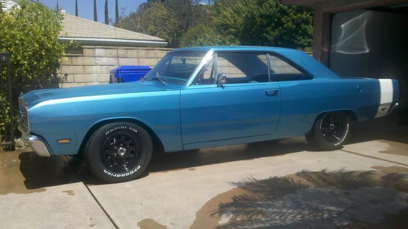

How are you wanting your wheels to set? I have 15x7 BBP Draglites on my Darts front end. I put all the additional spacing on the inside. They will probably be coming off this weekend. If no one has an answer for you, I'll post mine.

So... :scratch: .... that would be close to a 15 x 5 with 3 1/4 backspace right. :scratch: That would be the same outer spacing, but an inch deeper on the back of the wheel, right?
I just wanted to make sure the wheel wasn't going to tuck to far in or hang out of the wheel opening area if I went with a 3 1/4 on a 5 inch wheel.
:scratch: Anyone have a 5 inch factory wheel they could measure just to be safe!
THANKS IN ADVANCE
Also do you happen to have a picture of your car (not lauching)? So I can see how the wheel is tucked in/spaced?
Here ya go. Best I can do at the moment. Hope it helps.
Do you have plenty of clearance on the inside? Do you have a picture from the front of the car? That way I could see how far the wheel is tucked in?
Sorry for all the questions. I just want to make sure I get the correct offset.
THANKS! :thumleft:

Plenty of clearence. Picture from front angle not at the moment. :scratch: I'll see if I can take a picture of it this weekend.

I'll get a good set of pics for you tomorrow, and measure the backspace on my Welds while they are off. You'll have to subtract 2" since you want those skinny 5" :lol:
OK. I have Weld Draglite 15x7 with 4.5" of backspace. I based them off stock Mopar 15x6 (+1" inside) so the outisde sites the same.

My front wheels are 15 X 7 with 4.5" back spacing with 235 X 60 X 15 BFG TA's. The fit is perfect with no rubbing and you can see the car sets pretty low with stock /6 torsion bars and stock rear springs.
