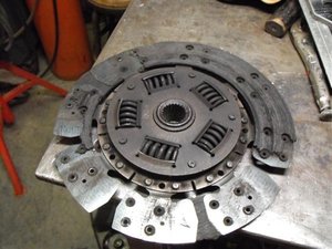

Well 5 years of ocasional abuse and oil contamination, results, jeez#-o clutch 001.jpg Parked it just in time, and It did`nt scar the flywheel, imagine that lol
