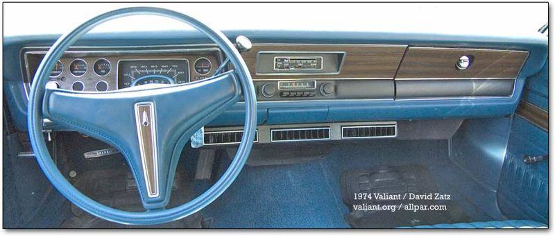

74 Valiant and long running Duster dash. what is under TEMP guage? Missing....

The blue dash looks like it has 2 lights under fuel gage and temp gage. Is one the seatbelt light, other maybe an EGR light or something.
