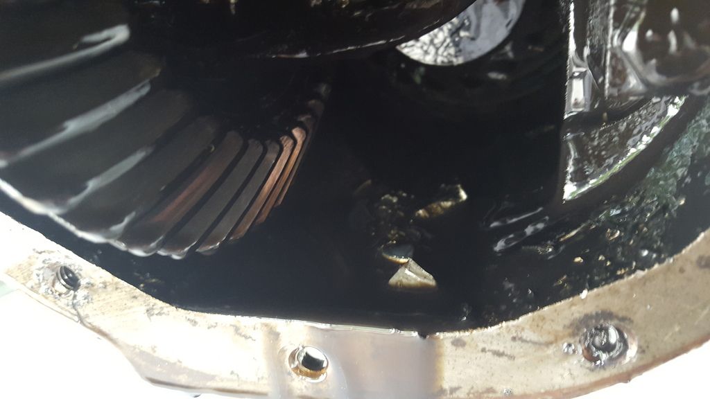

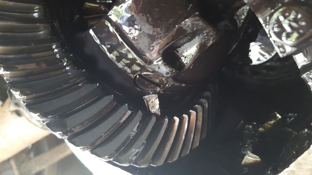

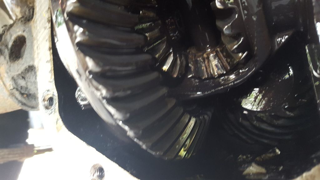

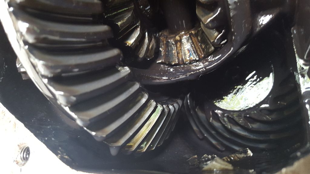

got the car jacked up, removed the inspection plate and this is what I found
on a side note, I noticed the transmission will still spin the driveshaft, so that means I shouldn't need to worry about it right?
oh, and the speedometer needle is stuck on 65, I wonder what caused that?
You didn't over rev it when it went out did you?
Hell, clean those chunks out of the bottom and turn it into a Lincoln Locker, lol.

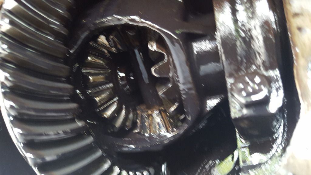

the lock on the cross shaft seems to have disappeared though, there is about 1/4 inch play on the pinion that still has gears on it
isn't this what happens to every 7 1/4 rear? pinion gears are tiny

X2weld it and take it out and really trash it that got a lotof abuse left in it yet .
5min with a stick welder.
now I'm getting tempted
if I would weld the spiders up..what would be the next weak point?
The rest of it, lol. Pinion, more than likely.
Like I said, a Lincoln Locker will get you a couple of weeks, it won't hurt anything, sure can't make it any worse.. It will drive like a spool. I wouldn't advise driving it in the rain though.....

my 7.25 pinion looked like a barrel and the ring gear looked like a donut some kid bit the frosting off of. Stunk to high heaven too. That was the SG version so I think I must have had some stronger innards.
Well at least it broke what was supposed to break.
I am kind of surprised that no one mentioned pulling apart your transmission to check the sprag......the weak link, which fails when there is a sudden unloading (like the differential breaking) of the driveline. Coincidentally, this is what likely caused your speedometer to stick. while it didn't overrev, the abrupt acceleration of the transmission output maxed out the speedometer, causing it to stick. Don't take this this lightly Google 727 failures........caused by sprag failures.
