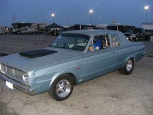

I just ran my 408/904 in my 66 Dart for the first time and ran 11.32@120mph,60ft was 1.65.Mind you still have some adjustments to do and should make 10,s no problem.Eagle 4inch crank,H beams,10.5 to 1,Eddy heads P&P,1.5 Pro Magnum rockers,.631 lift solid roller,M1 intake,AED850HO carb,all MSD 6AL.Tranny is 904 with 8 inch Coan 4500 stall,3.91 gears,1 7/8 tube fenderwell hedders,275/50/15 MT drag radials.8 pt. cage,frame connectors,QA-1 adj. shocks.Now to just get it to hook!LOL
Oh with the 200 shot of the juice,low 10,s for sure.
