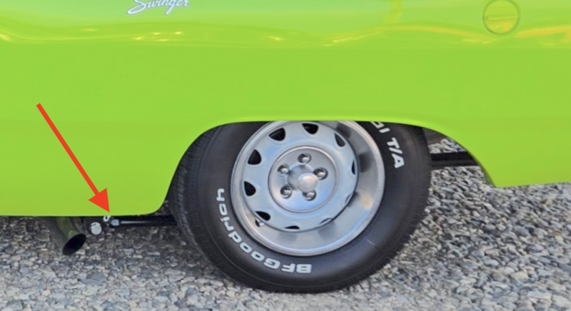

Regarding the sagging rear suspension, clearly they ignored restoring "that" so what else has been ignored?
I don't think it was ignored, it looks like it has CalTracs on it. So it may have just been set that low.

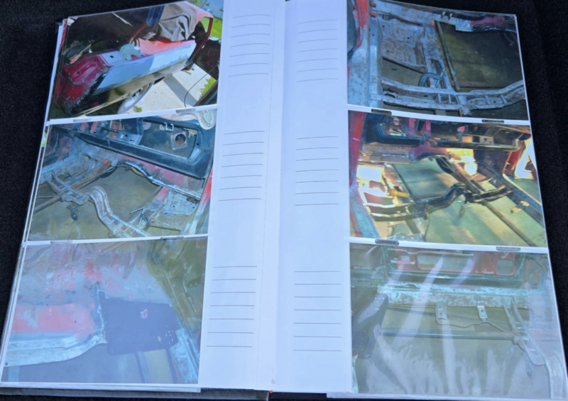

It looks like there has been A LOT of work done, so it would definitely be important to assess the quality of that work. Looks like the whole floor pan was replaced, connectors added, lower quarters replaced, etc.
And of course just the fact that there's an actual photo album with pictures on film says it's gotta be like a 20 year old restoration. It does look like it was a well documented job though

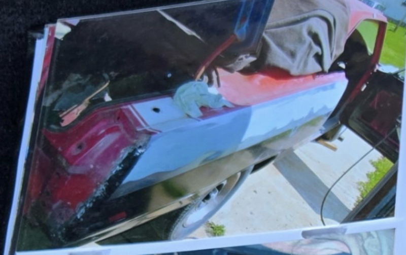

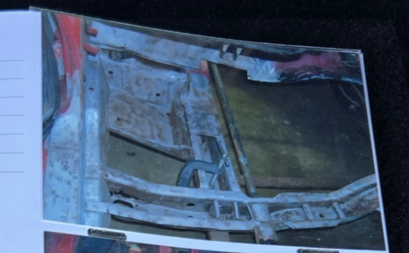

Here's some closer pictures of the album, you can see the floor and looks like the torsion bar crossmember were replaced completely, plus half of the passenger quarter. The rust in the crossmember doesn't look that bad, so the fact that they just replaced the whole thing would lean to it being a better shop. Obviously I can only see what's in the picture but that looks patchable vs a whole replacement, and they did the whole replacement.
You can also see the factory torque boxes

The only problem I have w/the rear height is that, the front didn't follow suit, thing looks like it's on it's way to a Knievel launch.
Not sure what they were going for there, unless maybe they just got the wrong springs for the Caltracs. Can't see anything but they probably just left the front suspension factory and at factory height.
