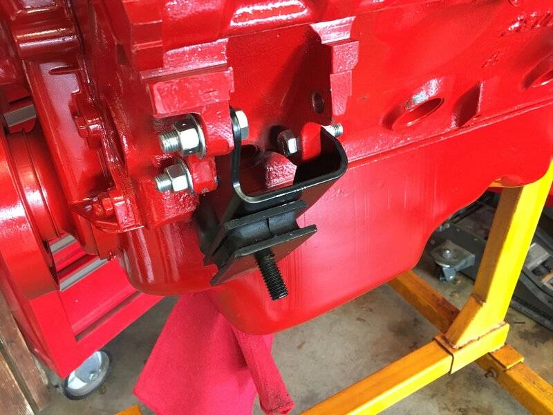

Thank you for your responses. What about the engine mounts? These are the separate bracket with the cylinder containing the rubber.
Black, with natural hardware.
Not sure on those, but a good guess would be no, like other under car items as motor to transmission brackets, linkages and brake components.
