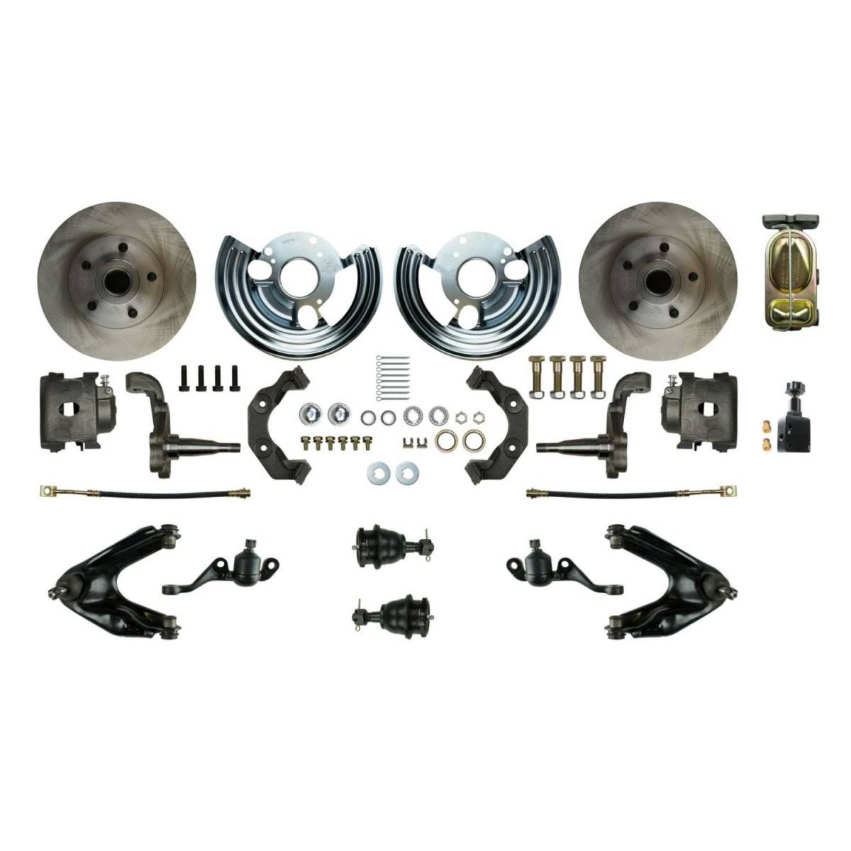

What are everyone's thoughts on this kit from Kanter? It's a little pricey but they will honor the FABO discount. Someone converted my Duster to B body brakes and cut down the upper control arms to fit, so I need EVERYTHING.
that's the typical BBP swap kit. it's made by "right stuff" so the fit & finish could leave a little to be desired.
no different than pirate jack or doctor diff. though, i'd take doctor diff over all of those any day knowing that the even if the parts were sourced from the same supplier the customer service will be LOADS better.
anyway, there's no magic there. if you have B brakes on there now, you might not need everything-- i mean, besides the modded uppers.
