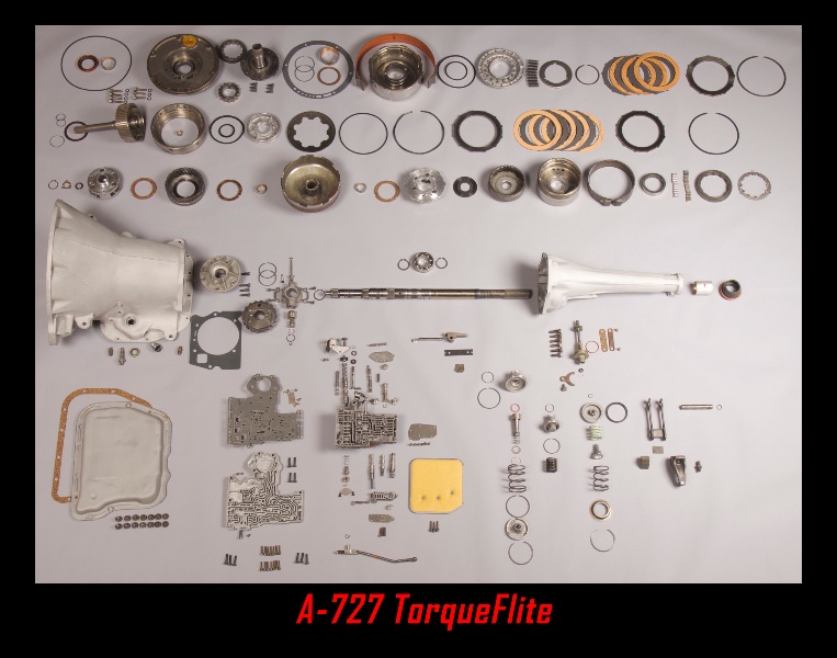

Scamp, thanks for investing in the book!

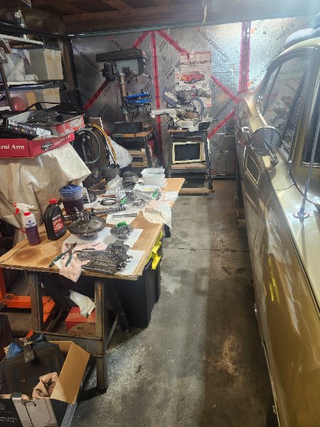

I wasn't sure if someone had been into our 904, with it being a 60 yr old car with orig trans. I ordered a deluxe kit I believe that included all the bushings. Bushings didn't need changing as they all showed next to no wear, so obviously someone changed them out prior to me. Too many variables in a transmission to not look it thru before ordering a kit. Mines been apart for probably 2 months now spread all over the **** shop lol
I have Tom Hands book as well as Boobtube to help.
