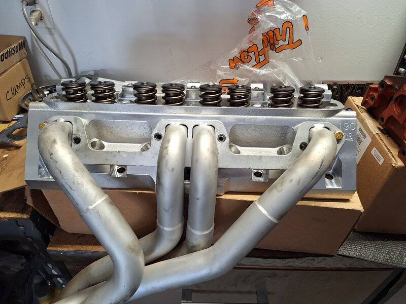

On my current build, I'm swapping in TF 190's for the stock cast iron magnum heads. With the stock heads I used a Remflex 6028 gasket with TTI headers.
The middle two TF exhaust ports are shaped more square than the magnum heads, which have a slight downward dogleg. Laying the gasket across the TF head it looks like the 6028 would still fit. The 6003 is for pre-magnum LA engines and I wonder if those would fit better.
What are members using with their TF's?
I bolted the TTI's up to the heads and they fit fine. I'm still debating whether to use the 6003 or 6027 gasket for LA engines, or the 6004/6028 gasket for magnum engines.

I'm thinking that they'll work because I was using Remflex gaskets on the magnum heads and I'm reusing the TTI headers.
They fit perfect on the bench.
