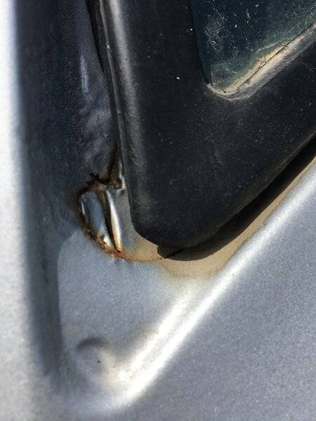

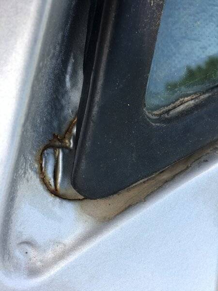

here is where my leaks are on both sides. whatever the factory put there must have been blasted off. where you see the rust is where the water is pouring in at.
i was just wondering what the factory used in those spots.
Window weld urethane, it sticks to glass, it sticks to rubber, it is black.
