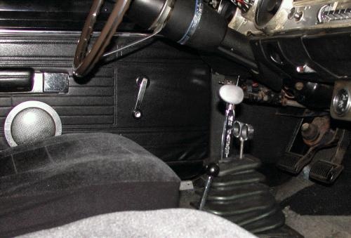

Before I sold my Duster, I removed all of the 4-speed stuff for use in the Barracuda. As you can see from the photo, I used a Ram Rod back then; I actually have 2 of them.
Now that I'll be running a T-56 in the Barracuda, I picked up an E-body Competition Plus and pulled the pistol grip handle.
