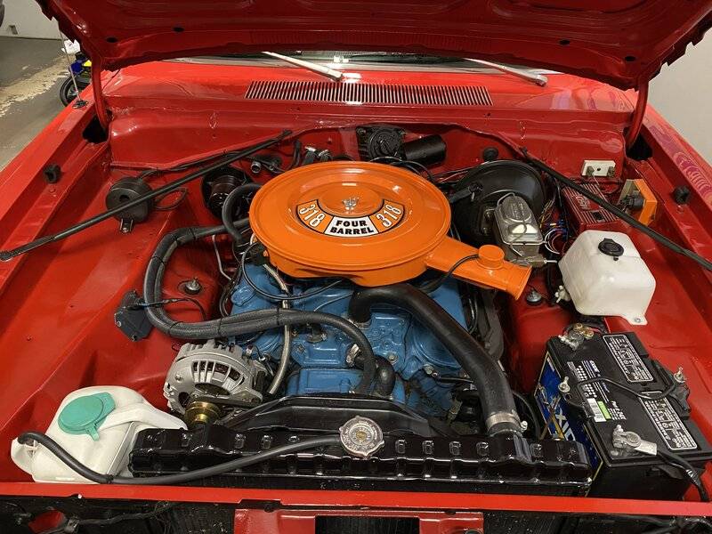

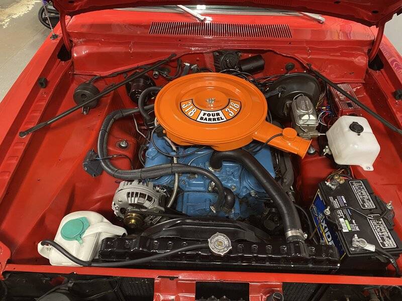

View attachment 1715805278 View attachment 1715805279 View attachment 1715805280 So I put this car back together with a driveline like it left the factory with.
318/904/8.25
The motor is basically stock with Summit cam similar to the mopar purple cam. Added an Edelbrock 1406 on a Performer intake and dual exhaust using 340 exhaust manifolds.
The trans is stock with a Transgo shift kit. The converter is the factory stock “ high stall “ converter used on the 74 Duster 360.
The 8-1/4 rear now has a sure grip with 3.55 gears. I got the setup from Dr Diff.
Rear tires are 245/60/15. The car is fun to drive and when you mash the gas she will spin the tires really good and chirp them when the trans hits 2nd gear.

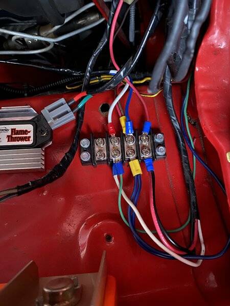

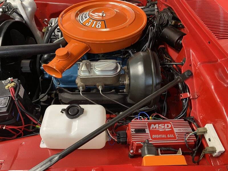

I put an MSD box in it today. The HEI modules kept shutting down. I think they didn’t like the available current on the stock harness “run” circuit. I’m already getting heat from the geniuses on Facetube that the car can’t have two ignition systems. Even though this car hasn’t run on the Chrysler box since the restomod. Looks ok looking in from the front and a little gaudy up close. Maybe I should pull out the ballast resistor and the Chrysler ignition box…
I agree with most here. Leave the 318 as is, but I would beef up the exhaust a bit (68'- 71' stock manifolds) or a set of headers. Build another "HOT" motor if needed for special moments(a one day swap out), but if you want to get a little more serious, a 727 and 8 3/4 may be in need. Now your getting into heavy springs, cooling, tire upgrade and such. Back to "leave well enough alone", nice car as is.
The exhaust manifolds are 71 340 manifolds with 2-1/2 dual pipes and thrush welded mufflers. vroom vroom
I put an MSD box in it today. The HEI modules kept shutting down. I think they didn’t like the available current on the stock harness “run” circuit. I’m already getting heat from the geniuses on Facetube that the car can’t have two ignition systems. Even though this car hasn’t run on the Chrysler box since the restomod. Looks ok looking in from the front and a little gaudy up close. Maybe I should pull out the ballast resistor and the Chrysler ignition box…View attachment 1715810002View attachment 1715810006
Interestingly, after the MSD install, the car idled in park at 1150 rpm.
She idled at 850 in park with the Pertronix HEI module.
I turned it down to 850 again and will need to check timing and carb adjustments with the new ignition
The MSD box is cleaner than what I had
Did you check to see if you were getting 12v to the HEI?
Yes, but I didn’t have a meter last time it quit while coming to a stop during a run. Car wouldn’t start but after an hour it fired right up and I drove it home. Module was warmer than I think it should have been. I am also going to order a Mopar performance voltage regulator just in case there was an issue with it.
In any event the MSD box is staying and I removed the ballast resistor and the Chrysler orange box. They were in there for appearances only. I’m already accepting of the presence of the MSD box and the absence of the prop original electronic ignition….
