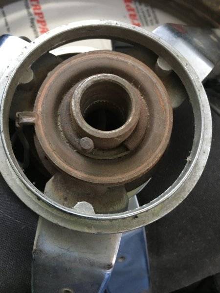

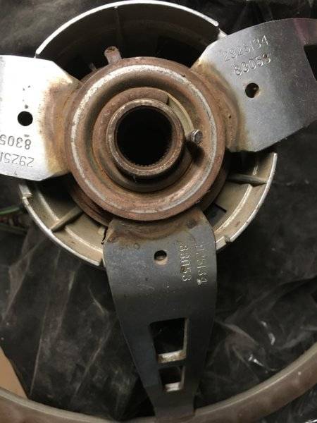

Here you go; they appear to be the same. The first pic is from a 65/66 wood sport wheel; 2nd is from a 68 or 69 wood sport steering wheel.
Yeah. That looks different that what I’ve got. Parts catalog I have also only goes from 64-66 for that piece.
I can shed a bit more light on the guts of the steering wheel - the copper horn contact which is secured to the wheel with that HD round spring is the same size for my early A wheel, the 69 wheel and a later 70's Tuff wheel adapter - about 2 inch in diameter. FWIW the diameter of the area of the steering wheel that sits on the collar for the early A column is 3.5 inches. For the 69 and Tuff wheel adapter, it is 4 inches in diameter.
