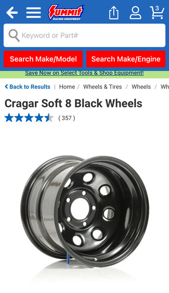

Sorry, didn’t read the desired style to well but Cragar Soft 8’ might be worth a look.
I’ve had them on my cuda before.
they come in 15 and 17”.
