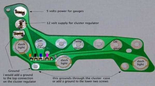

Hi all, I pulled my dash out on my 68 dart and didn't see were the condenser lead connected to the limiter, can anyone LMK???? I pic would be nice...

I don't remember, these change over the years. Might be it has a separate tab that plugs into the 12V connection? That is "with" the same tab on the IVR
Thanks so much for responding to my plea. I will check the cluster to see if pix apply to my application. Took me awhile to pull that dash the hard way.....then I checked this site and saw I have to drop column down to actually remove the panel...LOL

That does indeed help, lol.
