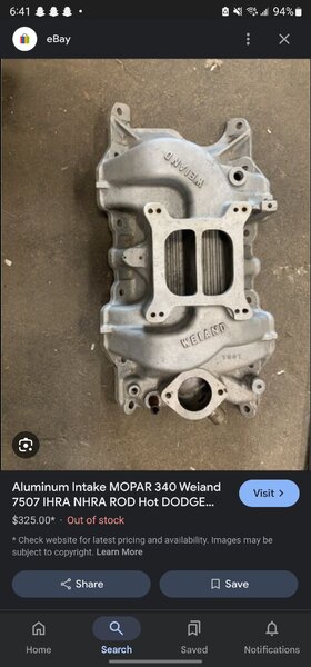

Should I upgrade from my current intake. My current intake is a weiand 7507 to a edelbrock airgap or something else i also have a holley strip dominator but I don't think it's really a good street intake. I want this car to drive good on the street but still have some power and look good. I like the look of the dominator but don't think it's a good street intake.
The engine is a 340 30 over low compression pistons with 202 j heads and possibly a small cam. And I have a few carbs for it but am using a edelbrock 1406 600
The engine is a 340 30 over low compression pistons with 202 j heads and possibly a small cam. And I have a few carbs for it but am using a edelbrock 1406 600View attachment 1716345698View attachment 1716345707View attachment 1716345715View attachment 1716345716
Keep the Weiand. A highly underrated intake. If you don’t mind doing some port work yourself, then I’d just match it and go as deep as you can.

The ports at the head are easiest to do.
The plenum mods are a bit tougher.
This is a good intake as is.
