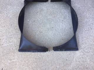

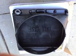

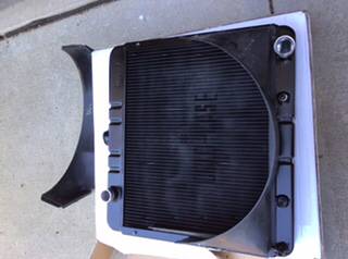

It is two top halves of a Ford Explorer shroud. The bottom of the Explorer shroud wasn’t close, so I used two top halves. I really like the two piece feature for access. I am too cheap to pay for a repop, this was $5 at pick & pull. I can post some details if you are interested
awesome. if you have something showing how you mounted everything up :thumbsup:

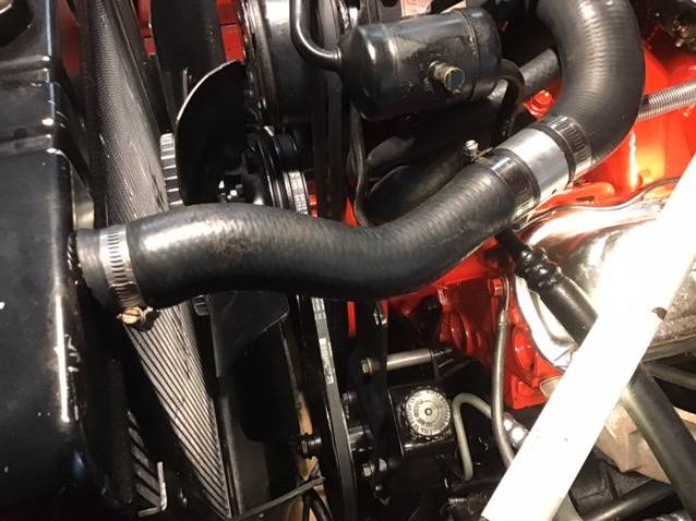

I’ll take some more pics this week. It took a lot of fiddling, but nothing hard. I trimmed the Ford mounting tabs off and used Allen head cap screws To fasten it to the oem radiator mounting holes and some self tapping screws to hold the two halves together.
The one potential deal killer on this is that it doesn’t have the Mopar offset on the shroud. You have to scoot the radiator as far as you can to the passenger side to get clearance. I remounted my radiator about a half inch farther right to get a little more clearance. Also would depend on what fan diameter you had.
If you have moral objections to paying $200 for a fan shroud and you like to tinker, this is a probably a good project. I bought a couple sets of shrouds so I could have some practice. I got 4 tops and they charged me for two shrouds. $10. You would likely have to pull the radiator to do it. Looks nice when it is done.

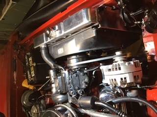

AJ, the picture is what my fan set up looks like. It is a seven blade fan off a 80s dodge truck. Is this a good fan?
I have a Hayden 2947 thermostatic fan clutch and a new cold case radiator, and a stock 180 t stat. My shroud fits very tight and contains the whole width of the fan.
It goes from 190 Cruising to 230 idling with the ac on after a few minutes. I don’t know if it would go higher, I stop it because I don’t want to over heat.
I bought a milodon t stat I have not installed yet. It is a pain to install with factory air. If this doesn’t work, I think high flow water pump is next?
the fan looks a little deep in the shroud. usually you want about 1/2 of it outside
I have heard that more than once, but it it makes no sense. It would seem that configuration would only reduce efficiency. Electric fans are not designed that way, nor is any application that I can think of. Walking through pick & pull looking for fan shrouds, I didn’t see that once.
I am speaking with no real data to back me up, so mine is just an opinion.
i've seen stuff both ways, the fan comapnies say 1/2 & 1/2, so who knows...
Yeah, I am certainly not an expert. That is the trouble with the internet, it is hard to tell facts from opinions. Back in the day, my dad used to refer to some things as “old wives tales”.....
would that shroud fit a 22" radiator ?? any idea what year Ford Explorer you got it from ??
I don’t remember the years on the explorers. I just used the top halves of the explorer shrouds for the top and bottom of my shroud. They were only $5 for a shroud ( 2 top halves made one shroud) so I bought several to practice with. They fit my cold case 22 radiator really well with some hillbilly mods. If you are interested I can post pics.
If you have the time, sure would like to see that. Thanks

Thanks for the pictures. Looks great. Going to need to find an Explorer. Do you remember if it was a V8 ford ?? What size/number fan are you using ?
I don’t remember. There were a lot of slight variations in the shrouds. I bought the shallowest one I could find. I have used a seven blade clutch fan and also a six blade direct drive.

Update on my Ford Explorer shroud. Looks like it is too deep for my setup. Causes it to run hotter at idle. Looks like I will scrap it. Nice try, but looks like I failed.
