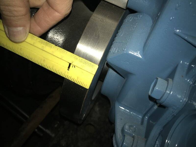

Anyone know the thickness of an OE damper?
I have two FD’s and two chicom FD’s and the FD’s measure 1 7/16 thick and the chicom knockoffs measure 1 1/2 thick.
I think your damper may be thicker than OE but thinner than the FD. I just don’t have an OE damper to measure.
I think your damper may be thicker than OE but thinner than the FD. I just spent have an OE damper to measure.
Thank you yellow rose! I’ll double check before I pull the trigger. I’ll let you know how I make out. Dan M
On both my own and that Pontiac that I did I had to put a washer behind each one of the water pump mounting bolts to space it out just a 16th to make it perfect. It's a little bit of a trick but it's doable...
Here is a link to March Performance. They say it’s a 3/4 inch difference between OE and FD. That’s a TON.
And, it’s a PITA to shim the pulleys that far. BTDT. You end up with weird spacers in weird places. And that’s a mile when using spacers.
It’s also possible your damper is somewhere between OE and an FD. Since my FD’s measure 1.4375 (which is 7/16) we can use 1.5 inches for easy math. According to March the OE damper would be 3/4 inch thinner than the FD, which means the OE damper is .750 thick, which is what my rickety memory thought it was.
