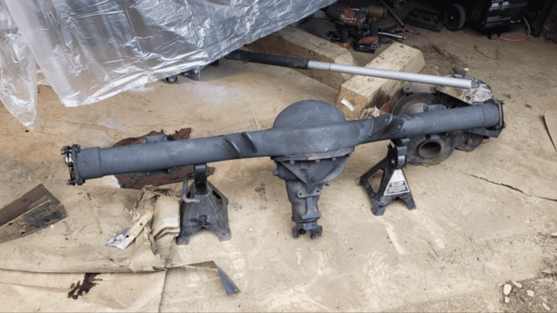

I have a dana 60 and all the stuff in a cart from Dr. Diff to build the 60 to swap into my car, was just curious before I do if anyone is running an 8.75 with with big power or if I should just do the 60. I also have someone lined up to buy the 8.75 for the $1600 I spent on the 3rd (nevermind the cost of chromo/green bearing shafts). Just sucks I'll have to have my driveshaft cut down for the 60 (its already 1350 joints) and I'll have to move my 4 link mounts on the chassis which is fine since I did all the fab myself, it just adds more to the to do list with a 60. Its a 70 Duster. Probably weighing around 3400lbs or so.

Yeaahh I have a 9" housing kicking around too, but I figured if I have to do the work to narrow stuff anyways I might as well do the 60 with 35 splines and never worry again. Especially since I can get the housing ends to weld on the 60 and retain my disc brakes with the ebrake cables etc.

I would go Ford 9"
Cheap, plentiful.
Easy gear swap like a 8 3/4.
Multitude of housings with whatever reinforcements you want or could need.
Heavily supported by the aftermarket.

My only gripe with the 9" is the 3rd member alone costs more than I can build the whole 60 for basically. And the 60 is definitely strong.
