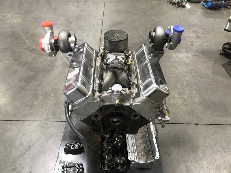

Somehow I missed that the question was for me also. No no one wants to see my junk, I haven’t started on my dart yet. I’ve got the falcon to finish I’ve posted some pics of, the TT big block for my boat to finish, posted some pics of that also somewhere here, and then, maybe then a build thread for my twin turbo 5.9 72 dart.
496 with twin 78s for my boat

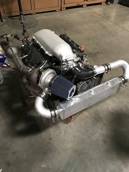

3.5 Honda v6 with gt35 for the falcon.

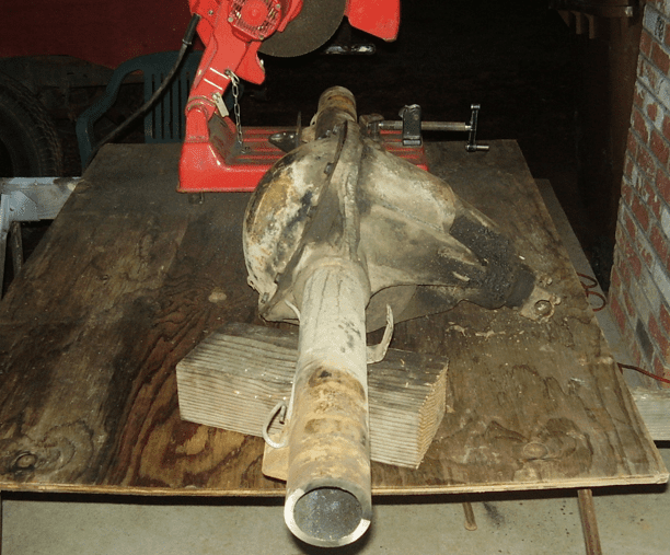

So I have the 60, but all I'm using is the housing. I'm upgrading to a 35 spline suregrip posi along with the new 35 spine shafts/green bearings from Dr. Diff. So it certainly wont be stock. I'll be $1600 in it with all the parts. Even less if the 60 I have is 4.10. I gotta crack it open, because if it is then I can use those gears again.
That's the exact route I went. Got the rearend out of a mid-70's F250 at a pick-n-pull w/ a 4.10 gear, Trackloc, and 1350 yoke. After selling the Trackloc, I swapped in a powrlock, added some Mopar housing ends, and a set of Dutchman axles with 5/8" studs (all parts from Dr. Diff).
You won't regret it! What is the wall thickness of the axle tubes in yours? Mine were 5/16"!!
