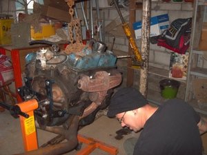

I just took my old engine out and started to pull it apart. 5 collapsed lifters, 1 head gasket blown, and a bearing gone. New engine A OK. my Bud snaped some pics of the new engine I'll post 'em asap

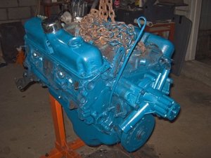

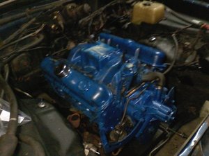

well everyone I've finally finished my engine swapped, stil tuning it but MAN much better, here's some pics (yea I know It's not mopar blue, but it goes with the interior of the car new engine.jpg here's the engine I bought before redoing it
new rings, rubber, and other parts all in!
Engine in car!
