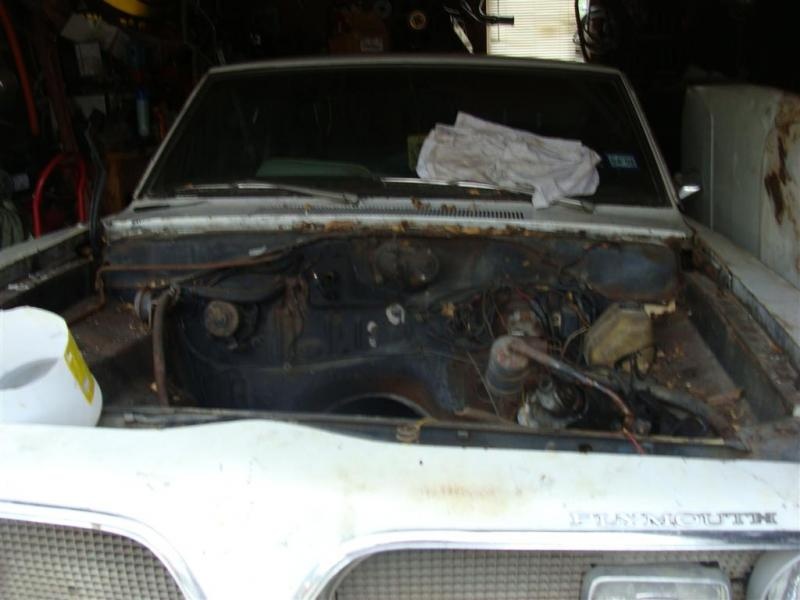

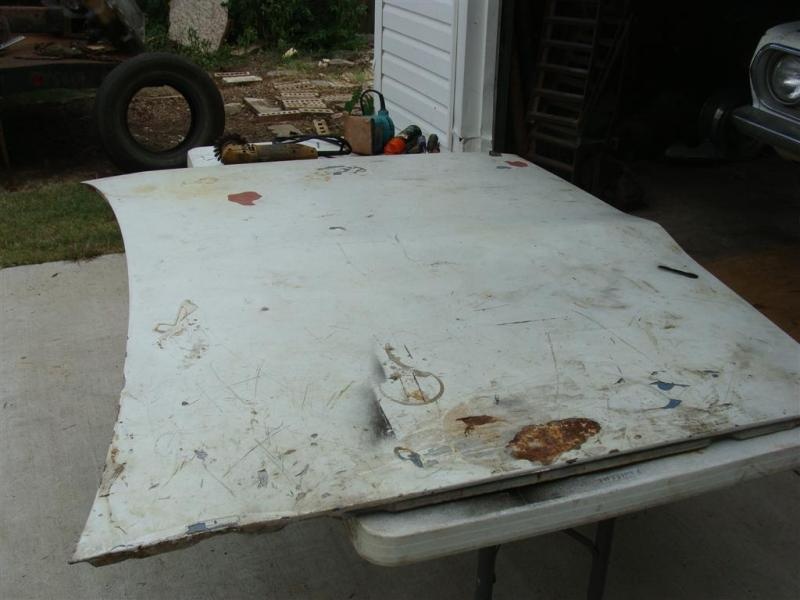

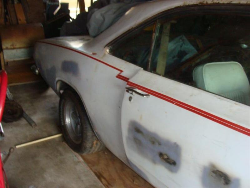

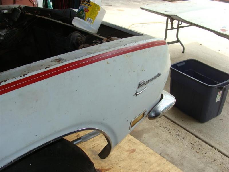

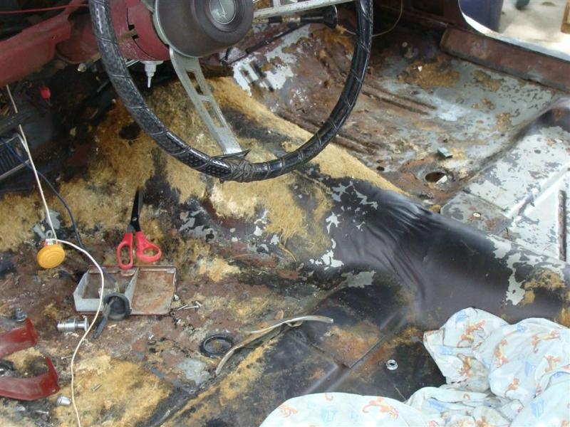

Finally I am getting started on the wifes Barracuda. Its been in the garage for 4 years. I am finally close enough on my Coronet to start hers. Here it is in limbo with matresses on top and heres what i,m starting with.

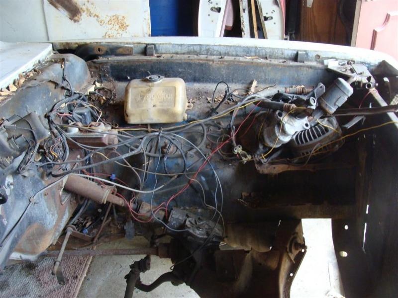

A few more and what i got done this afternoon. The dreaded bag and tag.

thanks guys and yes she,s got to help. Today i pulled wrenches and she bagged and tagged and chased tools. It helped immensely. At 53 i,m a little slow when I got to keep getting up and down.

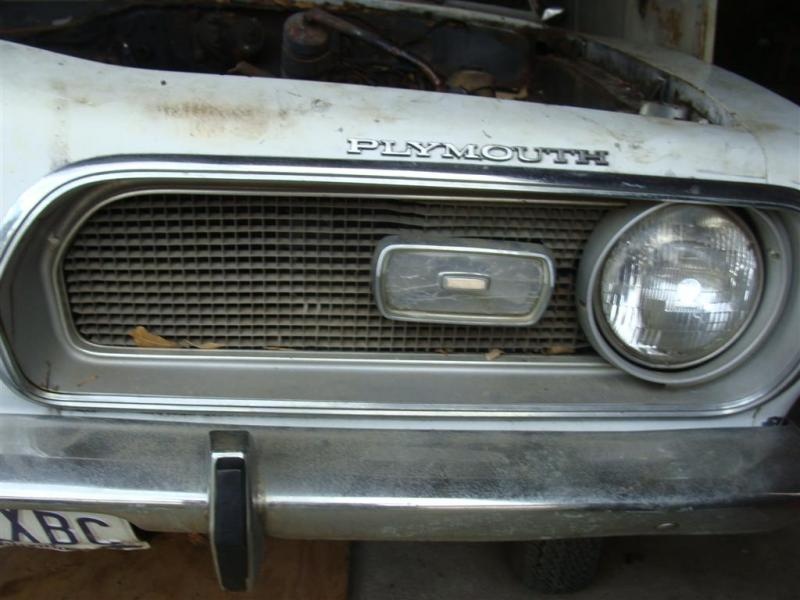

Cool project. Keep those grilles in a safe place where they won't get damaged. Those are hard to come by and very pricey.

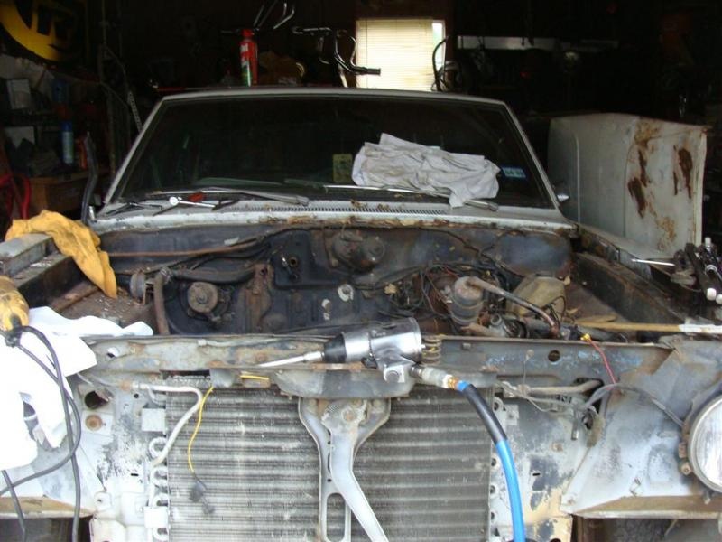

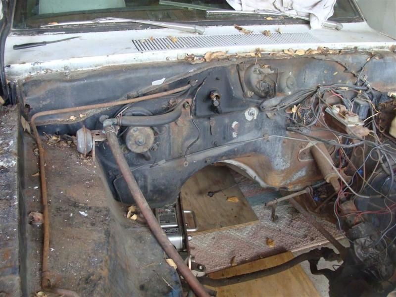

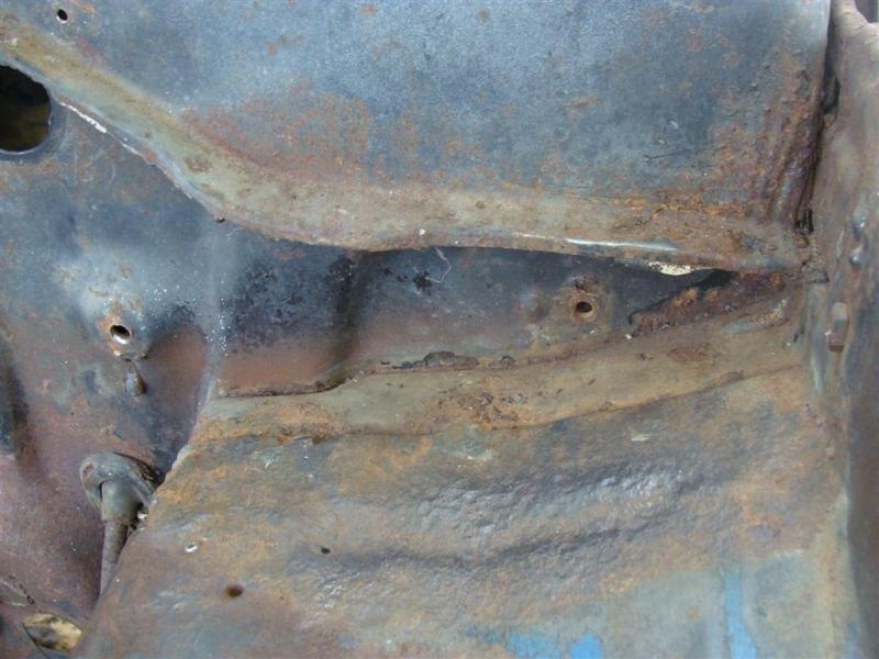

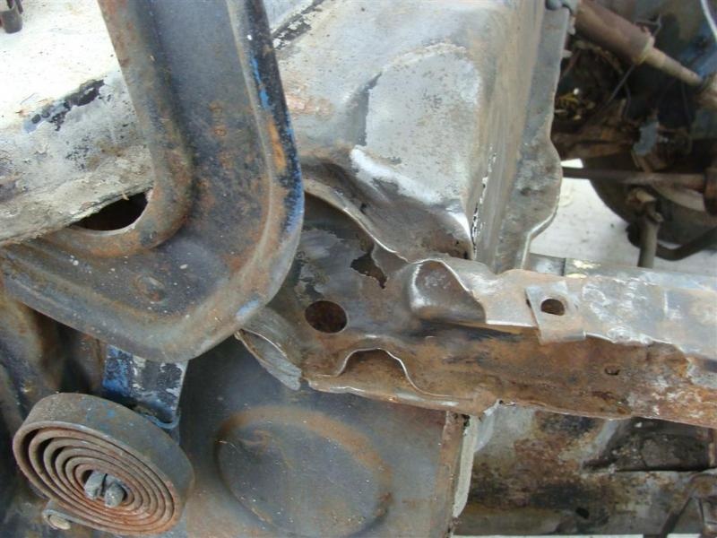

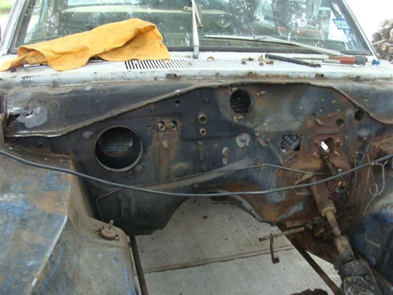

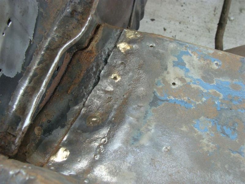

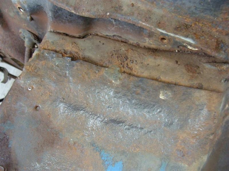

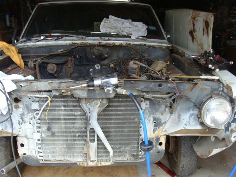

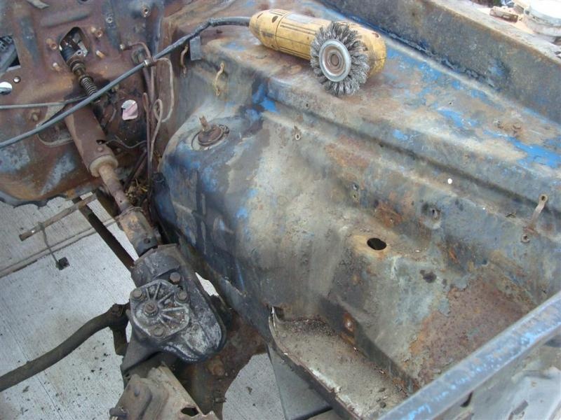

Got a little more done. Or should I say undone.Front clip has been changed. Inner fenders are b5 blue and I see some shoddy spot welds or is it braized. Oh well its just gonna be a driver. I will clean it up and skim it and shoot some epoxy and color on it.Thinking single stage. Easy to touch up.Any one have any advise on easiest method to ready it for paint underhood. Floors look really good. No holes at all and solid.

I used all different type ways such as paint stripper. But the side grinders with wire brush like you have really cut the time down.

Like mullinax said, the offset grinder and twisted wire wheel is probably the best tool for the first wack. Just make sure that you address the rust before you paing over it or all that work will be for naught. Yes is looks like some of the plug welds were brazed in. Is that the horn button or the starter button laying on the floor? Now that is high tech!!! L8r

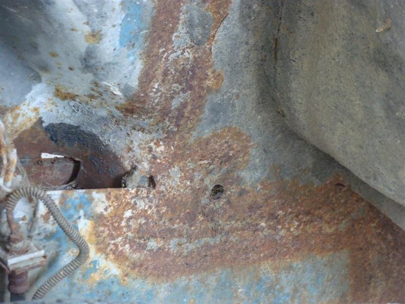

Horn button or starter button? Got me. I ripped all that crap out. Heres the progress today. All the rust was wire wheeled and sanded away and ospho,d a couple times.

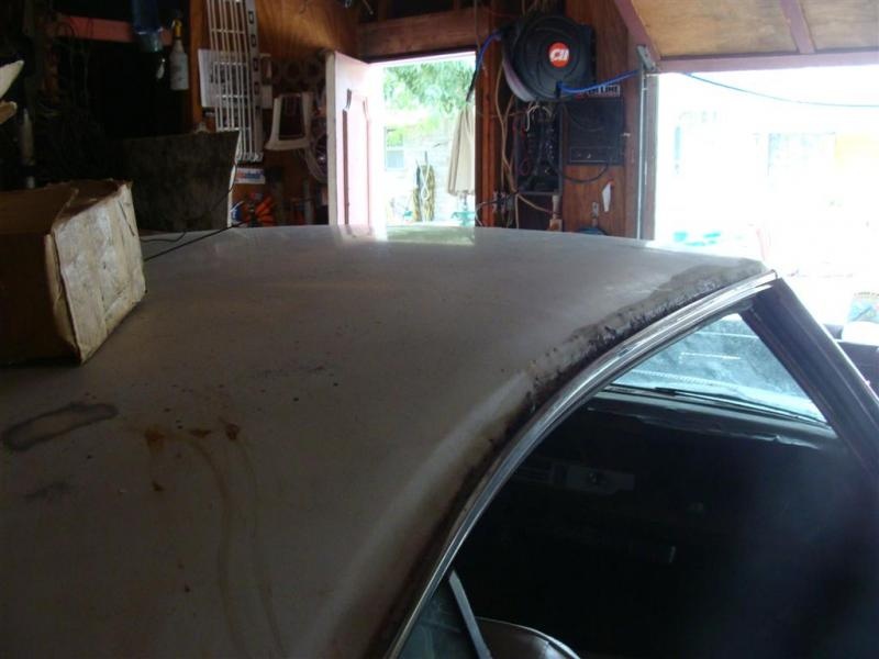

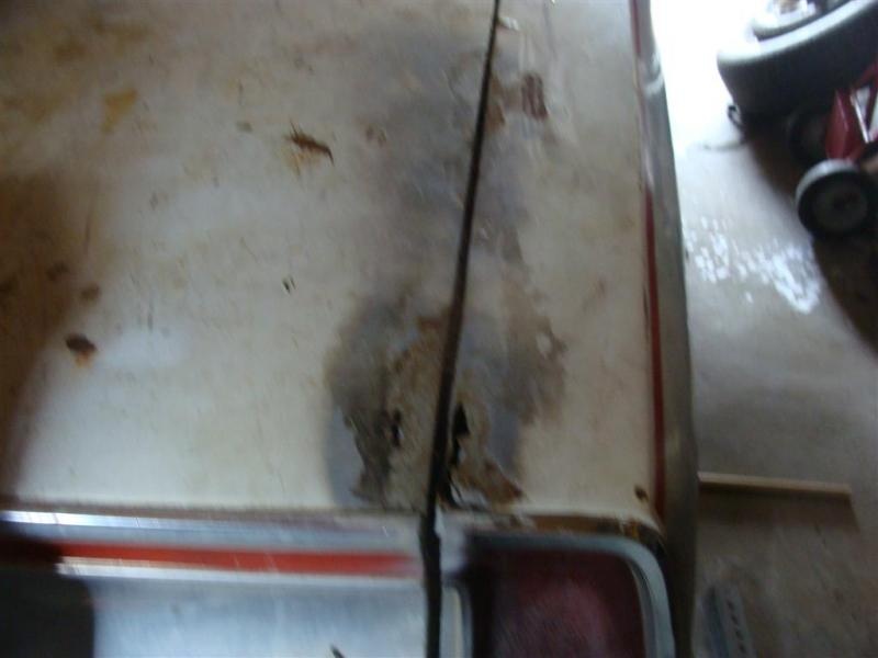

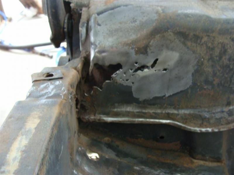

Stroker Scamp jumped in to help me out and sent me a rebuilt 650 holley. He cleaned it up and rebuilt a core he had and wouldnt take any cash. dang it lol cutting out rust from the trunk drip rail and whatnot today. Drip rail was rotted out at the top and in the corner.What can you expect for a 500 dollar car.This is gonna push my skills to the limit trying to fab the metal patches. Always listening to advice so let me have it.
