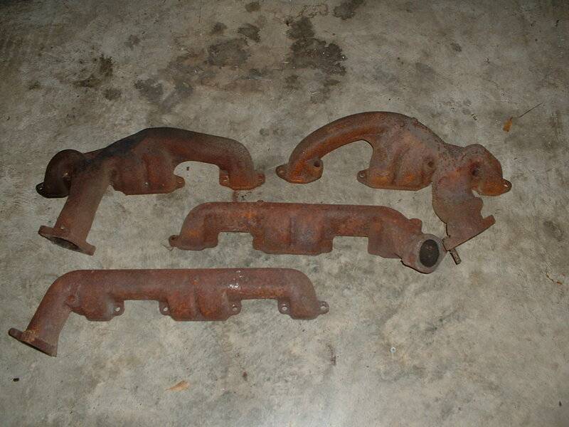

Interesting how people can think early 340 manifolds are barely any better than 318 manifolds, but 67 383 A body manifolds (below, top) are 45 horsepower worse than B body 383 log manifolds (below, bottom).
The bigger the engine, the more airflow.
The difference between log manifolds to the HiPo on a big block is probably different than a 318 manifold to 340 on an engine 100 cubes smaller
