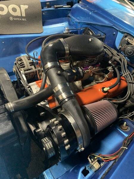

Survive a little boost? SpeedMaster heads, purple shaft, 360 craigslist
Core with a friends Atomic snail with an estimated 600hp, might be too much, just enough or needs an even smaller pulley? Yes, I do dumb things regularly, but that’s what keeps my insanity grounded. Picture is of it assembled is before I got it after being pulled from a nicely built engine. Going to finish the engine by July and hopefully get the power puffed on at after summertime.

Yea, it’ll live just fine with a good timing adjustments, enough fuel to combat the pressures seen and good work on the carb.

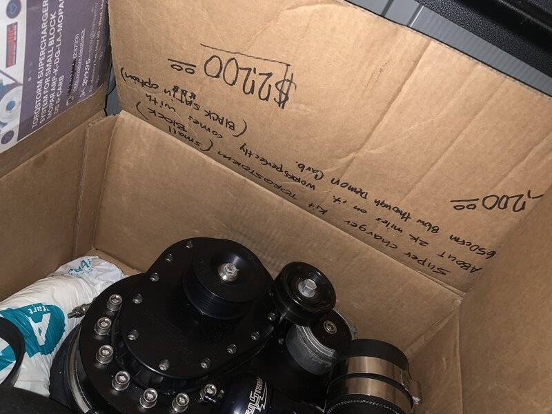

Who’s super charger and how many PSI should it put out?
The biggest issue is ring gap. If it were me I’d run it. Just treat her like a lady.
Torqustorm puffer, old school cam purple shaft of unknown info, cast pistons and a complete re-ring and rebore to Make sure it all seals up fine. Thinking with the heads and can, it would be a 300hp engine, then doubled with the 650cfm carb that was on the engine.
It’ll take more than 8psi. Fuel and timing are the critical items to be looked on. You can screw them up. Richard Horner has shown this time and time again.

How good of a tuner are you? And what fuel (octane) will you run? That will determine how long it lives. The crank will be fine. The cast pistons with factory ring gaps will die quickly if you get even a hint of detonation. If you add ring gap, and are careful (conservative) with your tune up it can be ok up to about 10 pounds, maybe 12, with the timing right and enough octane. But I wouldn’t push it much more than that.

And a torquestorm is a little small for a V8. Very nicely built, however.
And I bet rebuilder ring end gaps are not gonna be real tight/on spec.
