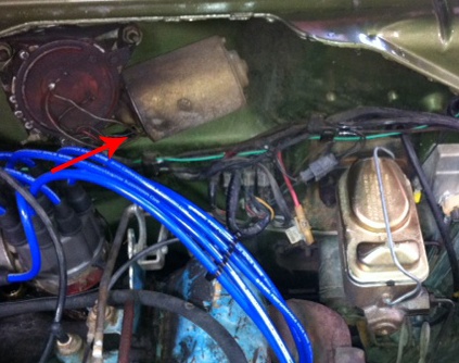

Anyone ever rewire the wiper motor with new wires? Mine still works but, the insulation on the wiring going into the side motor is all cracking off. The bare wires are pretty much touching.
The insulation is cracked beyond the hole they go through into the motor so I haven't been able to put new wires on. Is it hard to open this up and replace the wires?

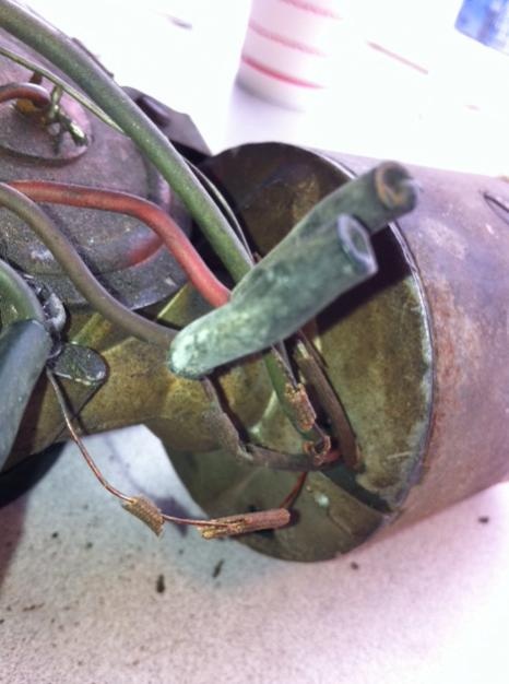

Does this look like what you were talking about? Some of the copper wires with the insulation coming off look like different gauges.
I haven't opened this up yet, but is it possible to replace the wires or cut them and put some shrink tubing on them? Or do they get too hot and need something else?
