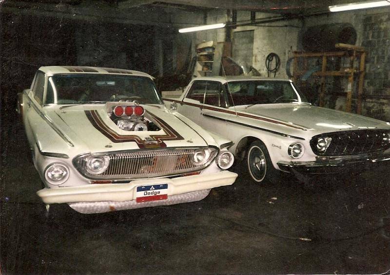

You have came to the correct place for info. Wait for the right person to see your post. An answer from me would just be a guess on these early years. I had them but mostly turned them into light weight race cars years back for people. There is a separate crowd for different year cars. 67-76 is what I know most of. unless your talking 62 -64
