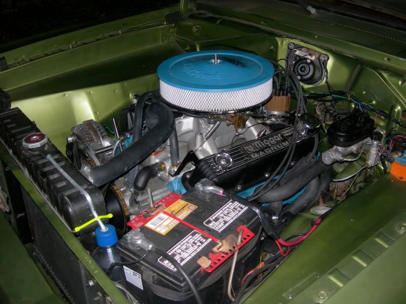

Hey All:
Well, its been a long time getting together, but my Magnum swap into my Dart is finally ready to attempt to start. Picking up the distilled water on the way home, and then I'm firing it up.
Starting point: All stock, plus LD4B and Street Avenger..
Brought the Magnum home:
Some of the extra junk I stripped off of it:
Iron RAM heads on sale!
As it sits now:
This was a long project. I started on it in earnest last fall. To be fair I did also switch to front disks and installed a built 904, converted to dual exhaust, and swapped in an 8.75 while I was at it. Also, the crappy economy kept the spending to a minimum (hence the clutch fan instead of electric, and lack of double pumper).
Still need to get a couple of spark plug wires with 90* boots, check hood clearance, etc.
But anyways, tonight after work I'm filling the radiator, and hoping it works out.
Wish me luck.........

I got my new throttle cable today, so tonight we'll see what it'll really do. I'll try to get a video if it actually runs.
Thanks for the responses guys!
Steve
Well, it runs pretty decent. Timing is jumping around all over the place though.
Sounds strong, makes great oil pressure. So far doesn't leak a drop of anything. Hopefully tomorrow I can actually get it on the ground and see if the trans is working properly. Then alignment, yada yada yada.
If it runs down the track as good as it sounds, I'll be pretty happy.
Steve

Hey:
Well, when times got tough around here I sold them. I got them at wholesale, so I could sell them without taking a bath on it. The Iron Ram heads were a lot cheaper, especially since I could use the stock valvetrain stuff. With the leftover cash I bought the miscellaneous remaining parts so I could actually finish the build and enjoy it a little this year.
Wish I still had the Eddies. I'm sure they would probably make more power than these heads. I KNOW they were lighter.
Thanks Bill!
I'm going to try to get a vid when I actually get the thing on the ground.
If things keep going this way, I've just got a little BS stuff to do, and then I'm rolling.
Oh, brother.
Went to put the car on the ground last night. The front wheels I got off of Fleabay are junk, so now the car's all ready to go but I need to drag the wallet out again and get some new wheels.
Hopefully I'll be rolling before the snow flies...
Steve
...what holley are you running ? I'll be darned if one of the numbers that are stamped all over my holley means anything but you carb looks like mine.
Thanks
Ian
