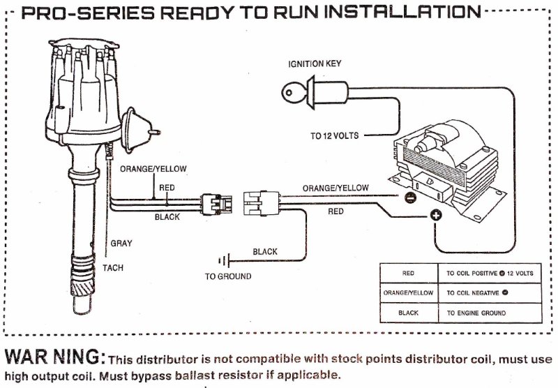

I’ve put my 69 Dart back together after many years it is an originally a 340 car now has a 400 base motor in it. Ignition has a 440 source ready to run distributor with matching coil. When I start the car it starts, but soon as I let the key go to the run position the car stalls any thoughts? The wiring has been all out of the car, but it has been gone through and I think it’s right everything seems to work except for hazards. If I run a jump wire from the starter relay over to the positive side of the coil, it’ll stay running. What am I missing? I’m sure it’s simple but stumping me.

Did you read the instructions? Do you have a factory service manual for your car with a wiring diagram? Here's the distributor instructions.
i did read the instructions , that is how i have it wired but i still have the ballist resister in place
so just eliminate the ballist resistor and connect the two wires together ?
OK, so I have power out of ignition one and an ignition too. Do I just jump one wire between the two to connect them or I’m lost here help
