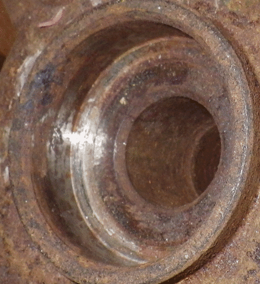

That's exactly what I was talking about in post 4 here.
I'm glad you weighed in so I can ask you.
Is seems like the way you finally figured it out would be that a rear main seal leak would be in front of the fly wheel and not affect the clutch face.
While a seepage from the pilot hole would be aft of the flywheel on it's face.
Is that the case?
I had already done mine to a later engine and I coated the inside of the hole with varnish.
As stated, I don't think the transmission input shaft touches the hole and I'm also hoping that later 70s cranks were not as porous as the ones you had to deal with. (76 is mine IIRC)
The register bearing will keep it where it is supposed to be?
Hoping.
And the thought occurs to me, that if all cast cranks are that porous, they all would be unusable with a 4 spreed car regardless of what is done in this respect.[/QUOTE
This is the long winded post I posted April 29 2010.
Here is the link read post 14
Search Results for Query: rear main leaking thru crank | For A Bodies Only Mopar Forum
