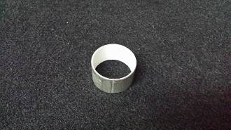

I've suffered from a similar vibration for a long time. Be careful using moly on the splines/inside the yoke. That grease can wash out into your transmission and lead to problems. ATF is a very efficient detergent type liquid.
My trans yoke is a new forged unit from Mark Williams. The outside diameter of the barrel is 1.505". Even with a brand new bronze bushing installed, it would wobble back and forth .030" at the u-joint, which I can feel is way to sloppy for new parts and the likely source of vibration /rumble when the driveline is between acceleration and deceleration or coasting in other words.
After years of suffering from this, I installed a teflon coated bushing from a GM 4L60 extension housing. It's a steel backed bushing with a single linear split and a white teflon or delrin inner surface. Ford C4's & C6's also have the same size bushings, but are harder to find the teflon/delrin coated bushings for.
I was about to have my yoke hard chromed to reduce the clearance, when the shop manager squeezed the GM bushing with his fingers onto the barrel of my yoke to simulate what it would fit like installed. There was virtually no detectable play, but it spun and slide beautifully on the yoke's barrel.
I installed the bushing yesterday. It slide in just like the stock one does. I put my yoke back on my driveshaft and installed it. It fit, slide and turned beautifully with absolutely no more side to side play. Problem solved.
I called my friend to tell him about my find, and he is going to install one on his car. He is a machinist and actually made an oversized bushing which still had a touch of play.
I now believe this is a solution for a problem that has plagued many of us Mopar guys for years. The new bushing and seal was less than $20 and it took a matter of minutes to replace in the car with a simple tool designed for the job.

No lube hole, but one just needs to be drilled and deburred to match the one on the bushing you take out.
Do you see or feel visible wear on your yoke?
An old timer at the transmission parts & shop where I grabbed the bushing said they wear a long time. I sure hope so.
He also said GM switched over to this material, and it solved a lot of problems for them. He's used them in C4 & C6's for years to resolve the slop issue, as they are a bit tighter than the babbit or bronze bushings.
I got one of those 4L60 bushings and it is too small .
No, the inner liner is teflon or delrin. It's white or light gray with a steel backing. We test fit it onto my yoke barrel prior to installation and squeezed it closed with our hands to verify it fit correctly. I verified the fit once again after it was installed and lubricated with transmission fluid. It fit perfect with no detectable wobble.
