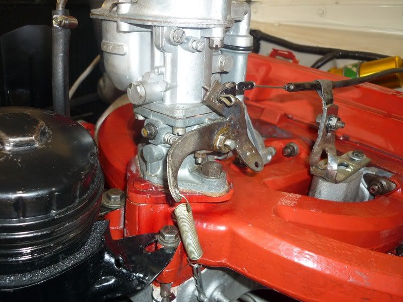

My '66 Dart is currently running a non-original carb - Solex from a Land Rover S2, and is running very rich (black smoke at the back)
Also, and more importantly, since this is a non-original carb, the kickdown linkage cant be connected! :(

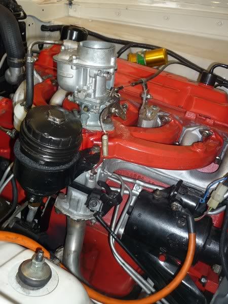

Here are a couple of pictures:
As you can see from the 1st picture, the kickdown linkage is not connected to the carb. And the 2nd picture shows that the throttle turns clockwise to open and the kickdown linkage needs to go DOWN as the throttle is opened. So I cant just fabricate something out.

this where a cable actuated version like on the B body slant 6's may come in handy. that way you are not dealing with a hard linkage alignment issue. Yours would have used the twist version off peddle.
