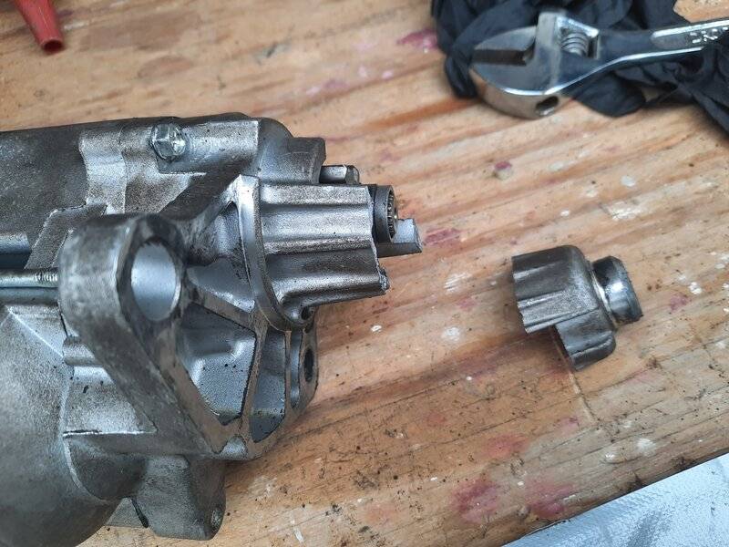

Update: I threw a core starter that works most of the time lol so I can try and diagnosis . With the coil wire grounded the motor cranks fine minus when I hit the broken teeth on the converter . It's gotta be something with the dizzy I went through.( I can be my own worst enemy sometimes) I'll have to pull it and see what I can find. I was thinking of maybe buying this Dizzy on Flea bay. Here's a pic of second broken starter .

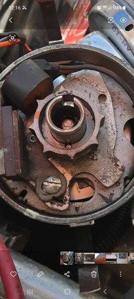

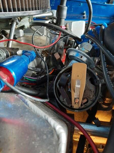

Still looking for my Piston bump stop :BangHead: But I set my balancer at 10' BTDC popped the cap and took a few pics. Still don't see anything wrong. I still need to drain out old gas and refresh. White mark on outer dizzy is #1 cylinder on cap.
10* BTDC is not enough initial timing
I would start at 16-18* and perhaps go up from there.
